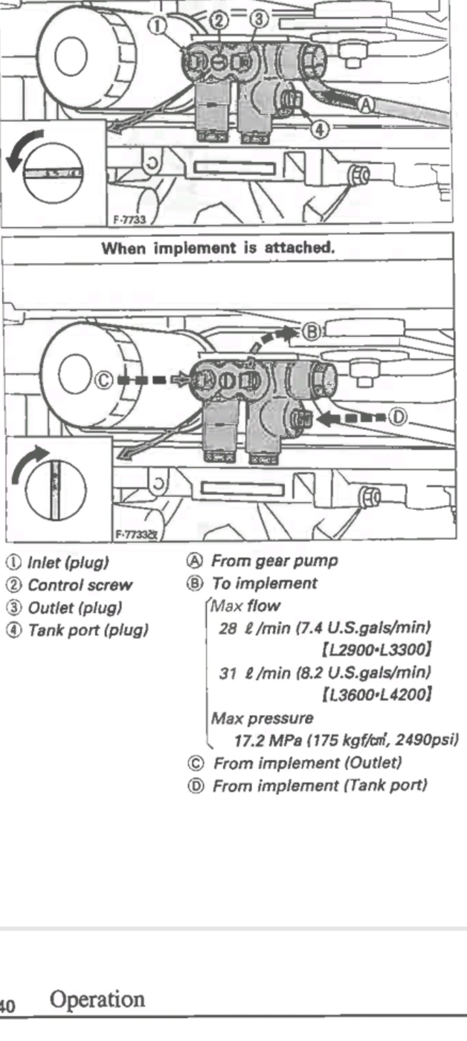

The main system relief is part of the hydraulic outlet block located just below the pump.
To test relief pressure setting connect a 3000 PSI gauge to the outlet port (B) on the block. turn selector screw (2) to implement attached position, and.stsrt engine. Pressure should be ~2500 PSI.
