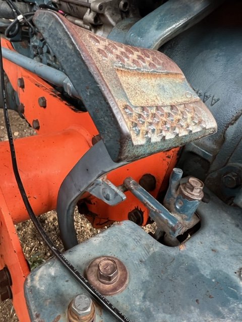

MAJOR UPDATE: Well boys, to be honest, I'm almost embarrassed to post this, but after reading your post, Po, I went to go check the PTO and noticed a metal bar by the clutch:
Clearly it is to lock the clutch disengaged 🤦‍♂️. I hadnt noticed it because the clutch pedal still has a significant amount of downward travel left, even with it under this bar. So After getting it on top of the bar (unlocked), the PTO stopped turning by hand.
So the PTO works now, H/N/L. The clutch is fully functioning too, it appears. So out of curiosity, I hopped up on the tractor and tried the drive....It works also!!! Shuttle shift is functioning F/N/R! I drove it back and forth a few times and the shifting is seamless. (excuse me while I go throw away my hydraulic gauges.) Wow.

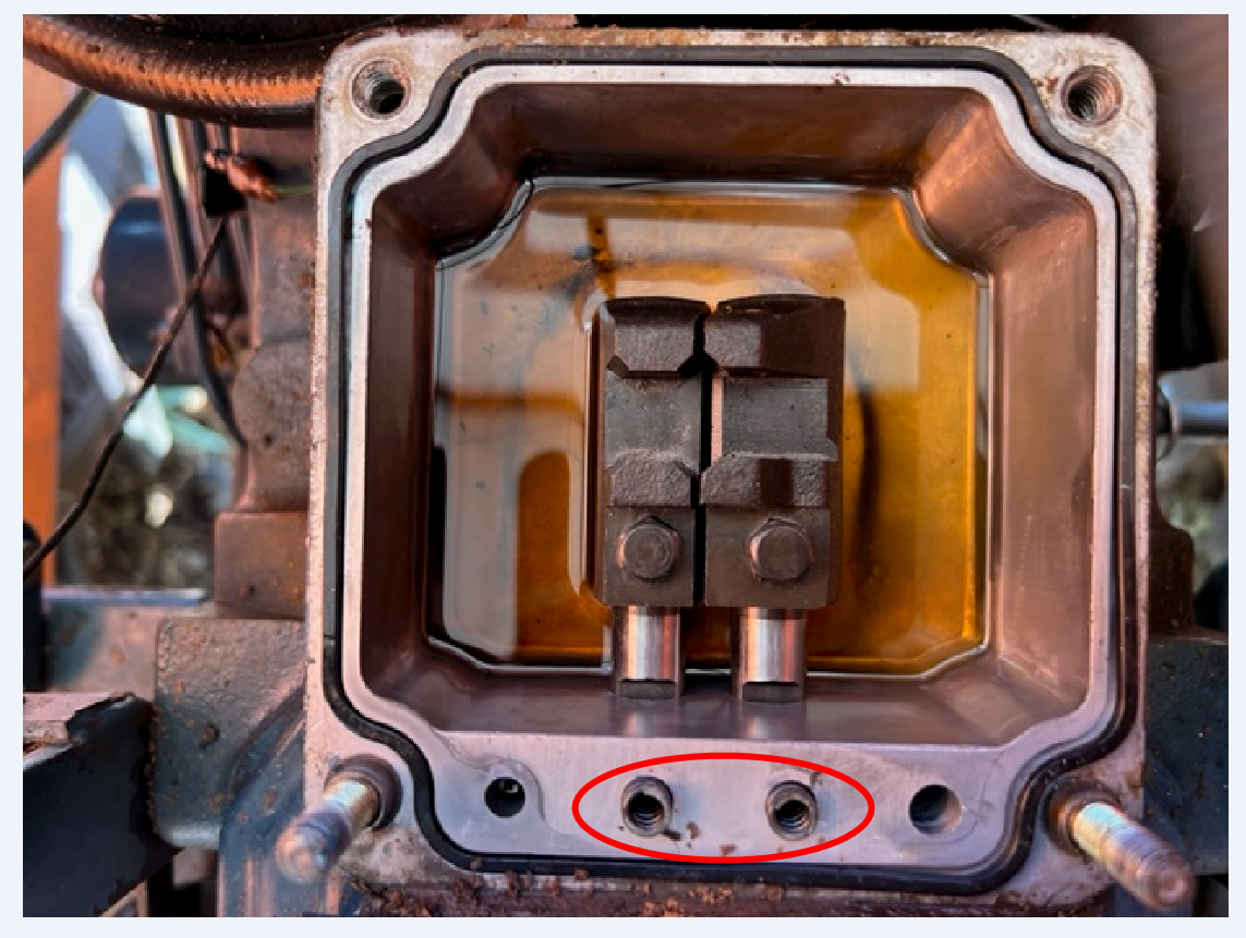

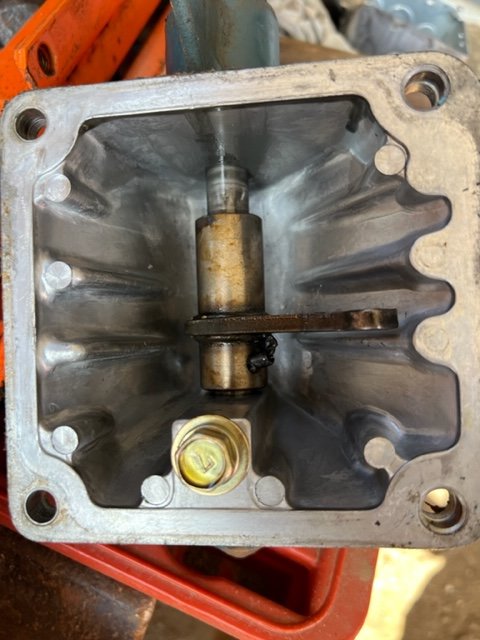

Update: I pulled the cover off the main gear selector today. This was rotating freely front to back with no gear engagement.
Not much under the cover, pretty simple design...two sliding shift arms with detent balls and springs Gasket still looks fine also. I'll drop some shop towels in there and clean the surfaces, gasket, and probably get a turkey baster to suck some of that junk out of the bottom:

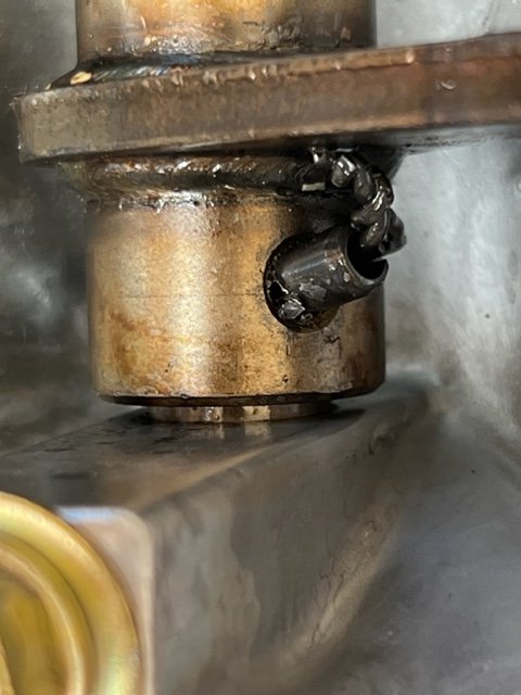

On the top side, it was as I had thought (and hoped) the spring pin was broken and the shift arm was freely rotating around the shift rod:
Theres a wire that Kubota installs through the spring pin and candy cane's the ends. They call it a locator wire, which I assume is - as in this case - not to lose the pieces. Although I'm not really sure where they would have gone, it is just a bowl underneath. In my opinion, it was much smarter for Kubota to make it a bowl, and not have it open straight to the bottom of the transmission case. But Double protection I guess?
Here are the pieces removed, cleaned up and lightly oiled, til the new pin arrives. The detent ball goes in the cover for left to right detent. Gonna try not to lose it. :cool::
Honestly, I'm glad the pin is getting replaced before I get everything buttoned up and then it breaks. It sees a lot of repetetive stress, I'm sure. So best to replace now. New pin should be here Thursday, and should get it buttoned up and tested. 🤠

Is there a spring in there also?
Yes, it is under the bolt in the pic of the top cover. The detent ball was small enough to fall out when I removed the shift rod, but the spring is too long to make the corner. I'll likely have to remove that bolt to reinstall the rod, and drop the ball and spring in, after.
