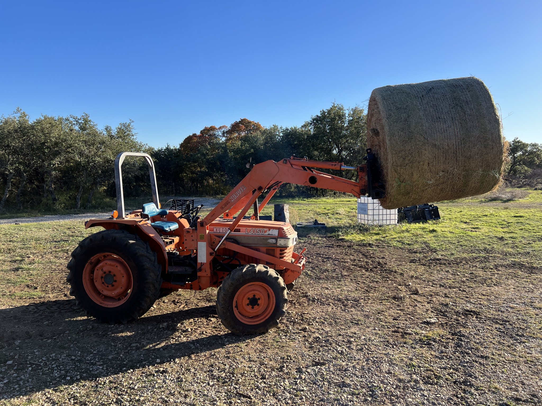

I do still have a hydraulic leak under the 4wd drive shaft housing tho. Even with a new seal. Will investigate that more later. But with my bobcat in the shop at the moment I needed to put this ol girl in service feeding hay.

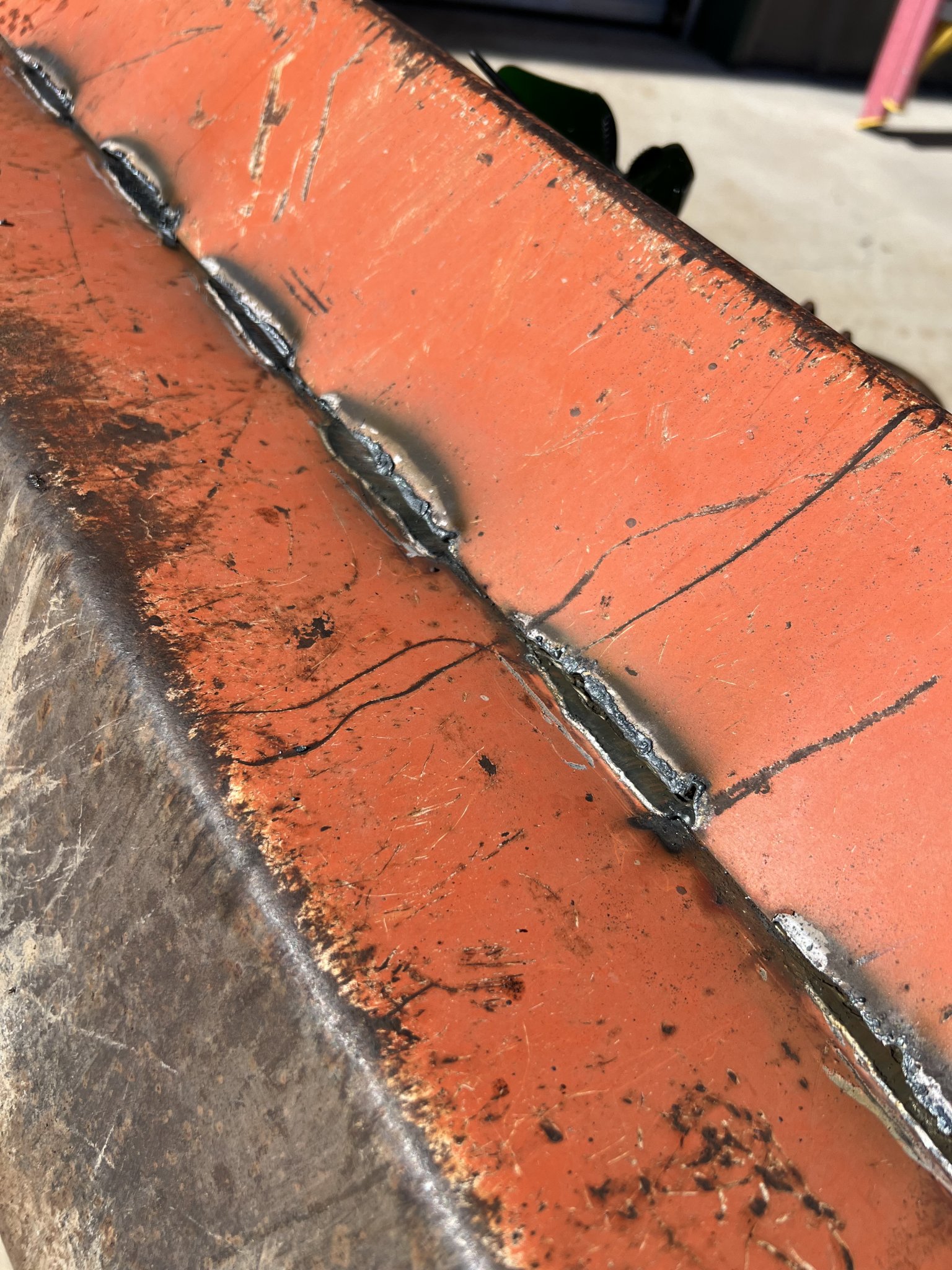

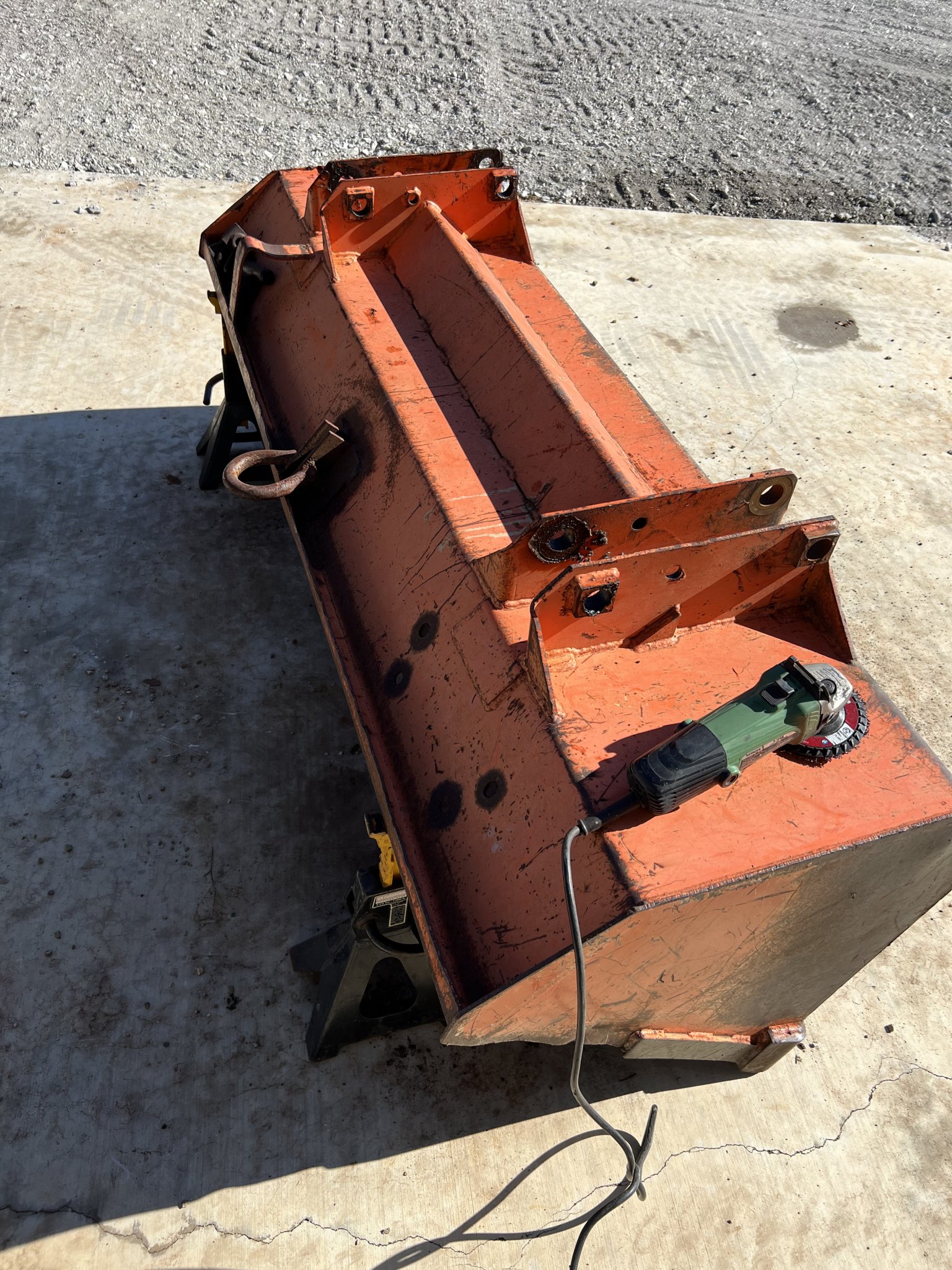

A retail SSQA runs about $1300 shipped and without a 3rd function or a good idea how the tractor would handle the attachments I decided to break out the plasma and do some cheaper weld-ons for now.
So my plan was to use the plasma and a flush cut cartridge to cut the bracket off the factory bucket. This was the first time I’d used the flush cut cartridge but wow it’s awesome.
Super quick and clean cuts with minimal grinding to be done on the bucket before adding the SSQA plate.
After tacking a couple of pieces on to hold the outside brackets I got them lined up and welded onto the QA plates.
it mounted back up great. I left the middle support on and will be adding a plate between the two QA’s just for some stability but for now, this will do to get the cows fed.
and viola, happy cows!
