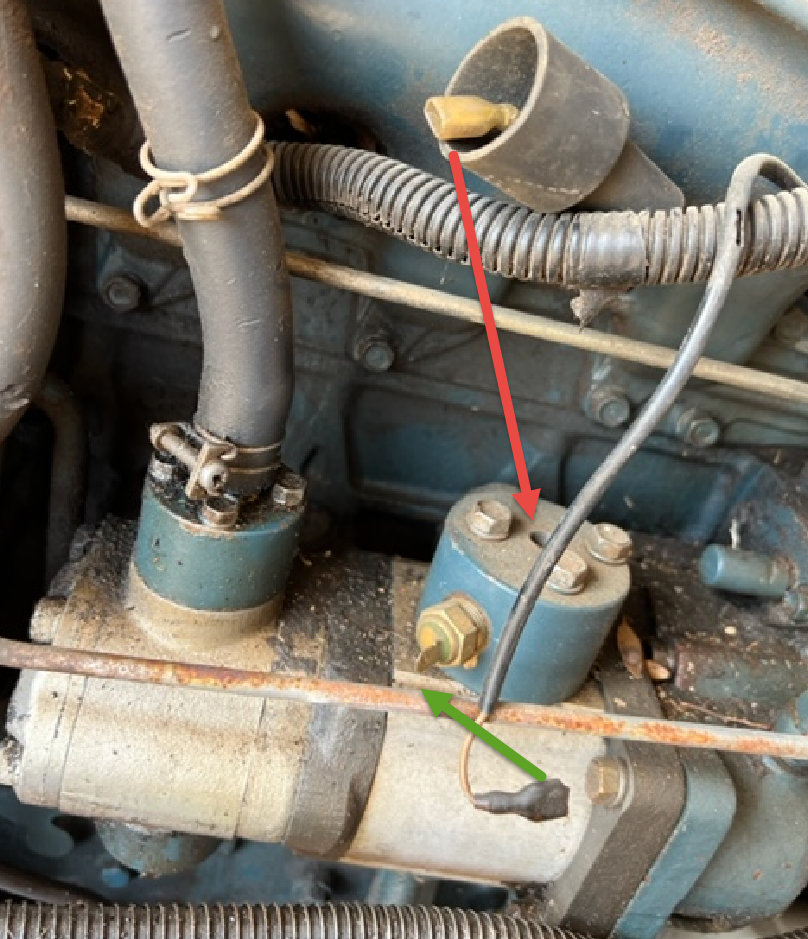

Update: Ok, so found another missing part...
I've been wondering where these two connections go, but kind of ignoring the electrical for now. Turns out there's a vacuum sensor that goes on top of the hydraulic pump suction line (where the red arrow points). Since it isnt installed, the hyd pump is just sucking air.
Granted, I should have noticed a threaded hole on top of the suction line, but i didnt. And it doesnt show in the parts diagram for the suction line. Only shows in the electrical section. 🤦‍♂️
So I took a gloved hand and put some clean oil on the finger and covered the hole, and almost immediately the engine torqued down and started working harder at idle. I think we are finally drawing hydraulic fluid, or at least trying to. Still no 3-pt lift. but we are closer.
The pump started getting very warm, quickly. I'm assuming thats typical, and heat from compression/pumping is normal.

That is not typical - it was running dry which will kill it in pretty short order.

You may have figured this out, but you have a tandem pump setup. The power steering has a separate section with a separate reservoir, and one section of the pump (looks like the rear section) serves only the steering. So your steering issue is/was not related to the shuttle. You might want to check out the quantity and quality of fluid in the reservoir.

So maybe that's the purpose for that missing vacuum switch on the pump suction. Is there an associated indicator light on the dash? Besides the brakes, you've got clutches contributing friction material.

Alright I owe you Po. First, yes, from what I read, the vacuum switch illuminates a light on the dash that says you are not picking up hyd fluid. If you have a dash connected, that is. 🤣

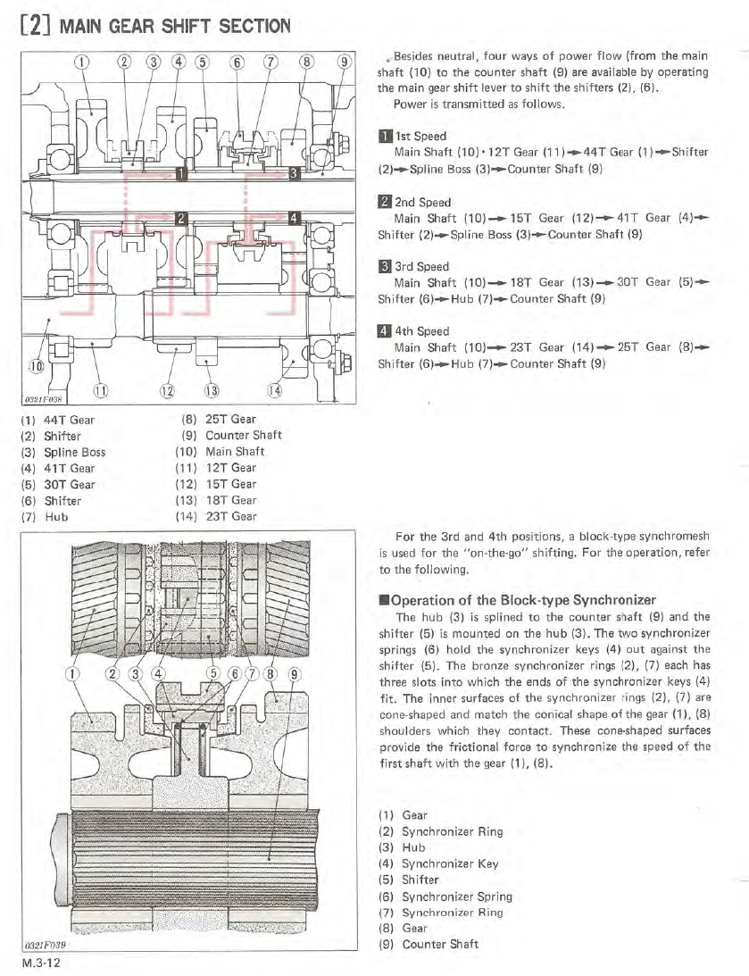

1) Main gear shift. I was able to slowly get the side to side movement to get it out of the middle of the ”H” guide:
but once I get it out side to side it moves back and forth freely. Not good.
that probbly means either the pin 120 is broken or the lever itself 110. I guess I’m pulling a seat off to get to the main shift cover. getting it in gear seems To be th only way to test the PTO. And then the final thing will be the actual shuttle shift.

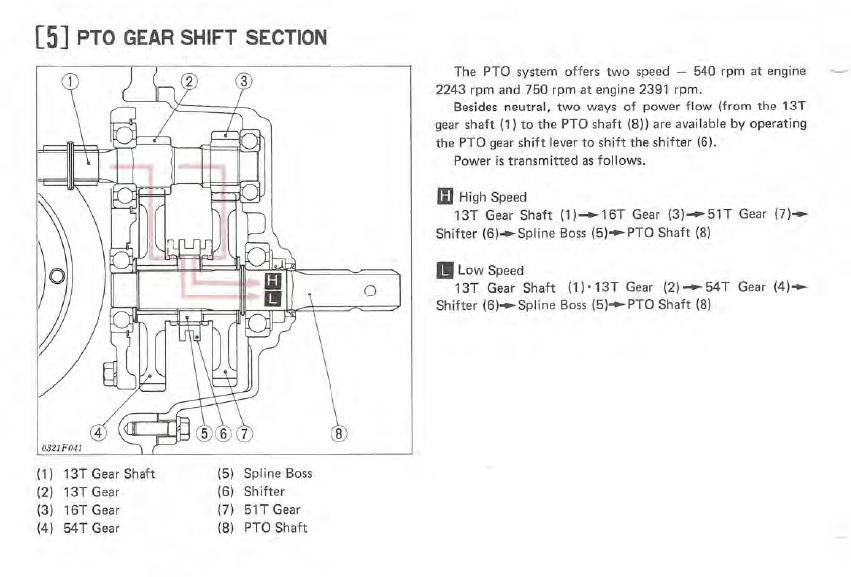

While the PTO might be independent in the clutch, I am assuming I still have to be able to get it in gear (Main gear) before the PTO or the drive will work? Is that true, or is the PTO completely independent of the main gear neutral?

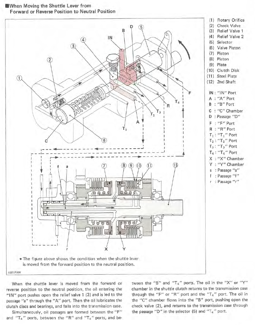

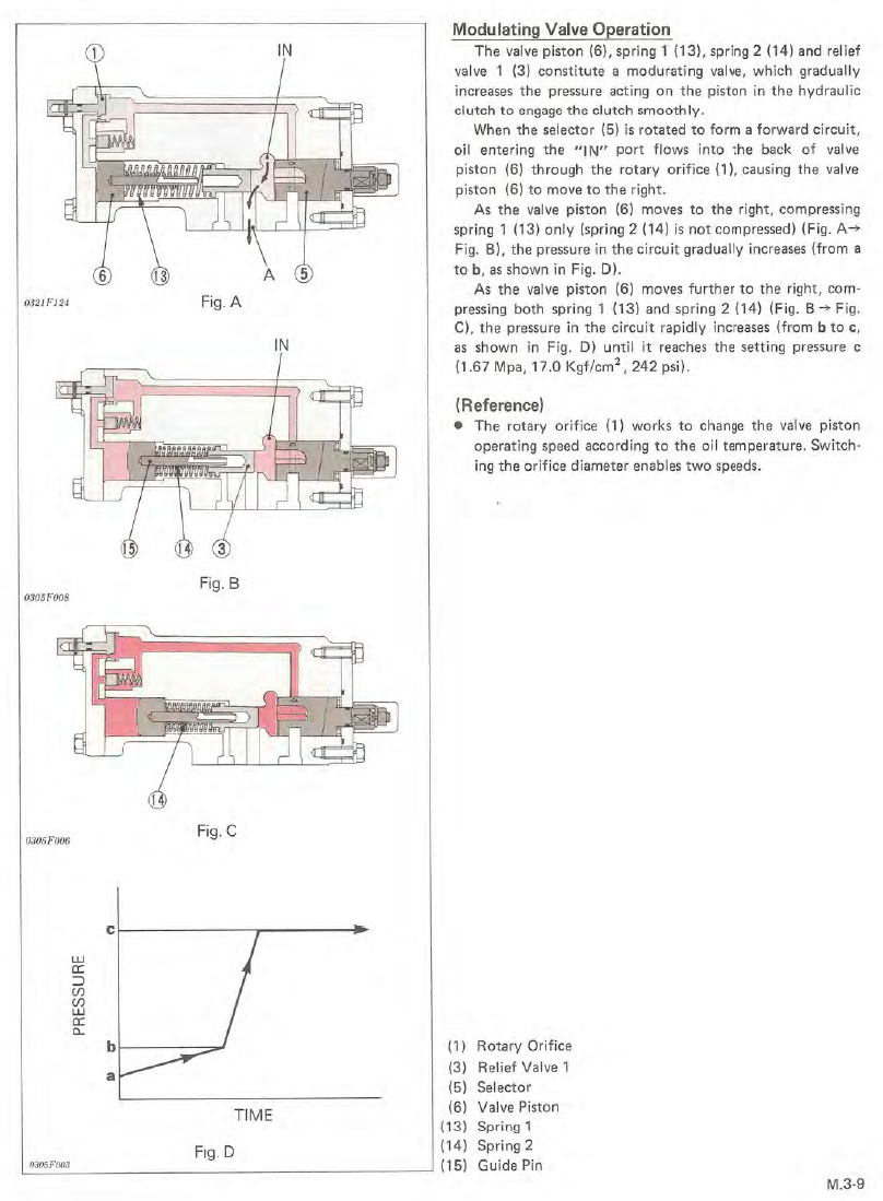

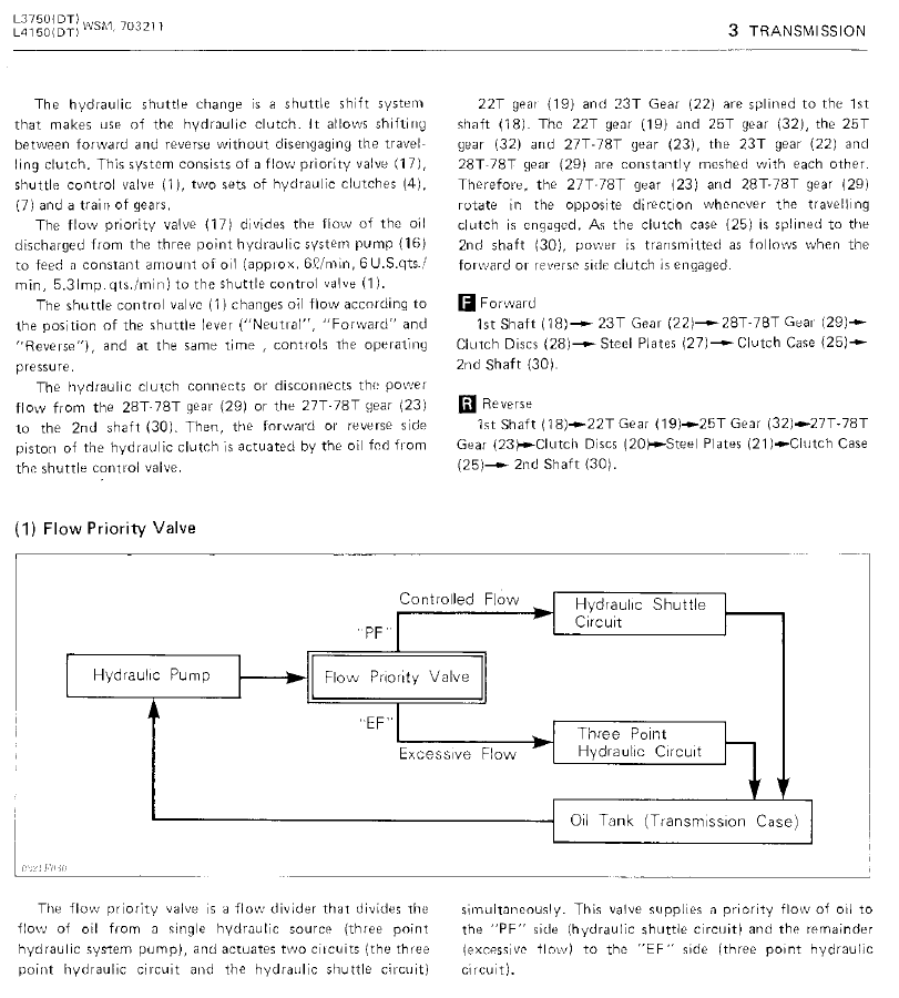

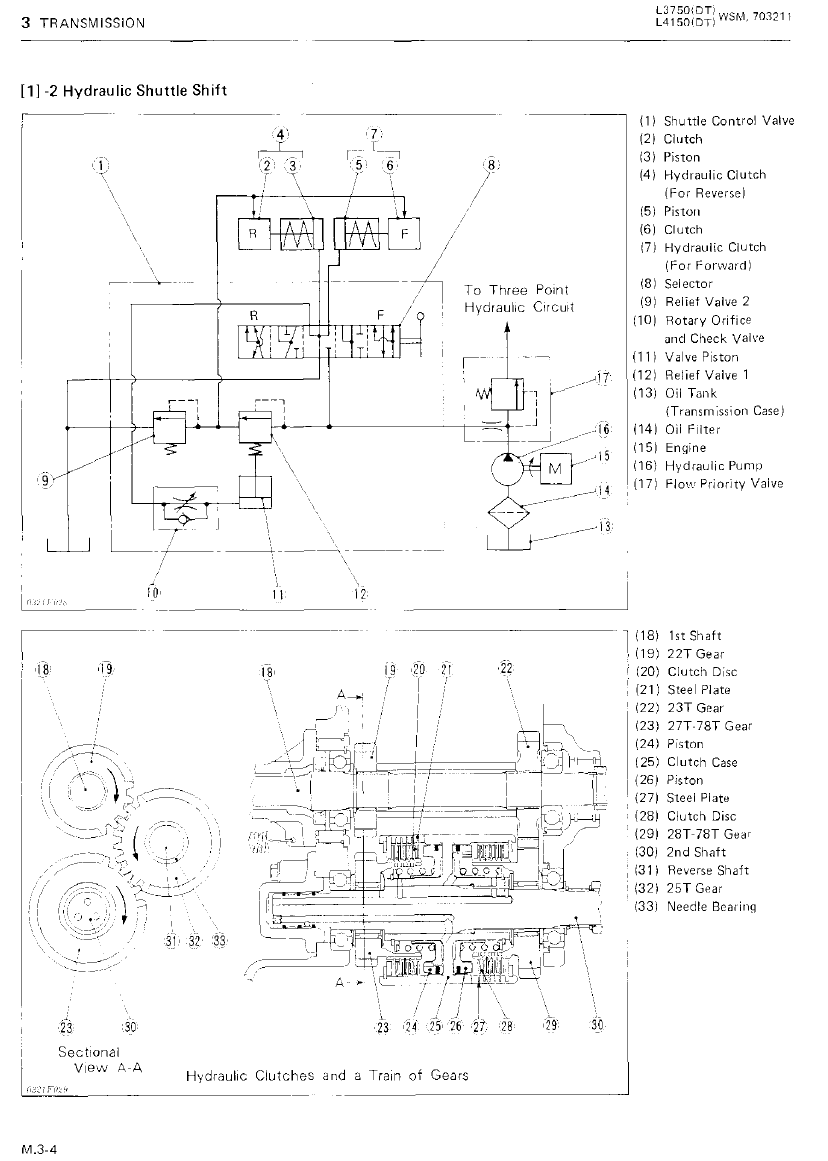

I think it's entirely independent, but can't tell for sure. You don't happen to have that manual in PDF?
CiscoRanger
L4150DT / BF900
Oct 3, 2022
259
133

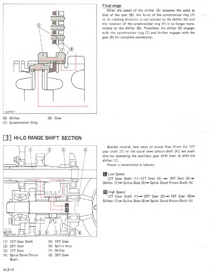

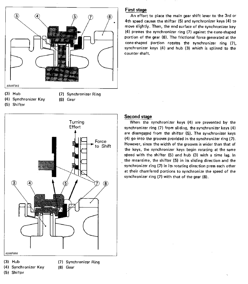

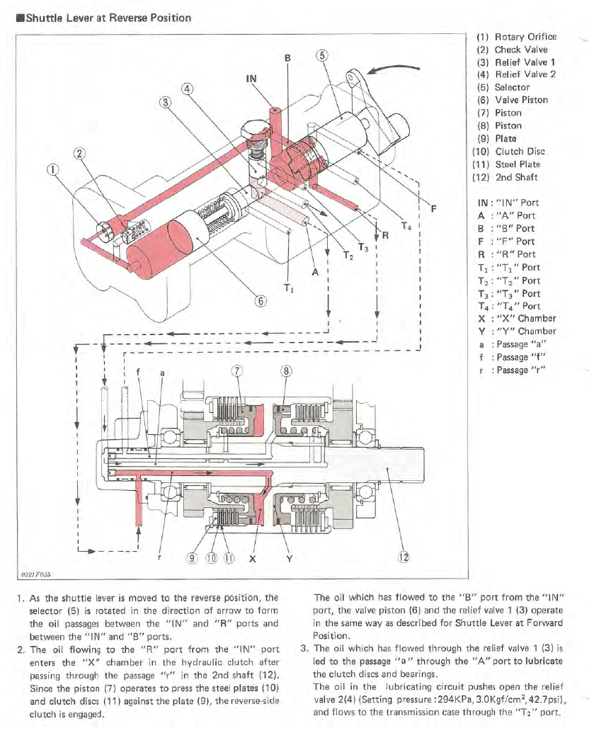

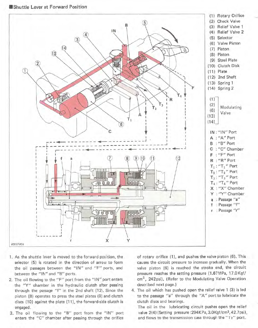

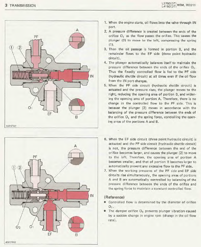

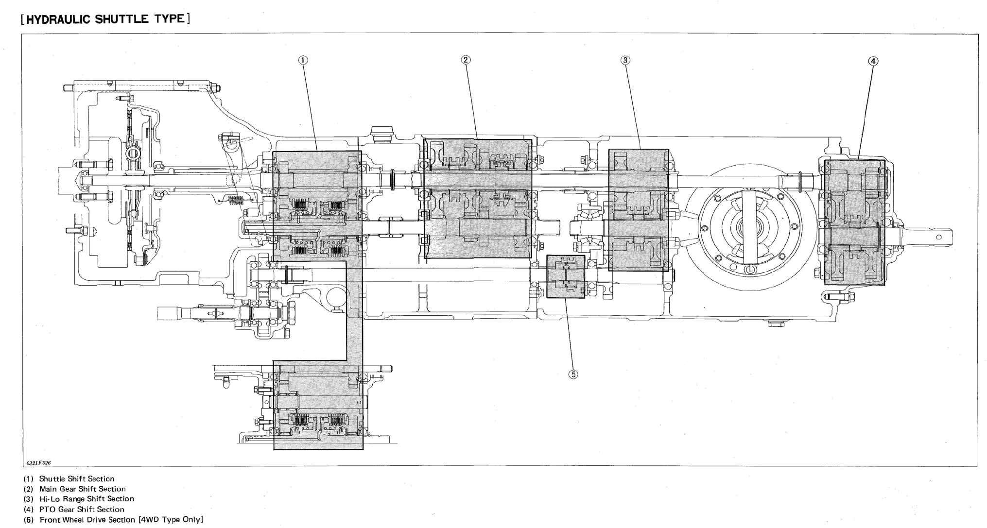

Its not gonna let me upload it, its too large at over 100mb compressed.
Heres pictures of the pages of the transmission section... first half...
