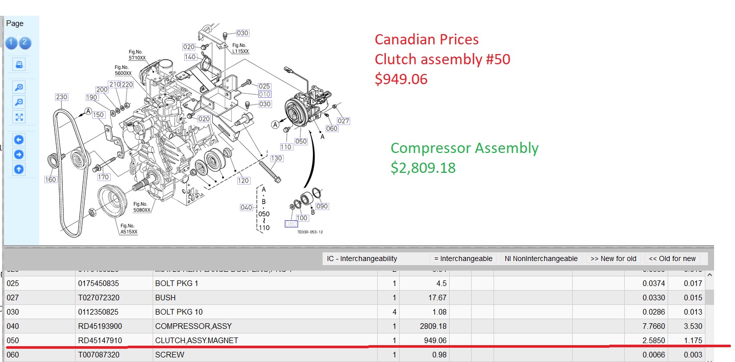

The coil inside the clutch can fail. Typical coil resistance is around 4ohms - if its high (open ckt) the coil is gone. Usually can find a coil (or whole clutch) for your compressor - same as used on many cars. A whole compressor with pictures is listed here for comparison.
Replacing just the coil, or the whole clutch, may be possible on your model by unplugging and unbolting the compressor, leaving the refrigerant hoses attached. Turn it out so the end is accessible and take off the pulley/clutch. There's a screw and snap rings holding the clutch together on the compressor shaft.

The clutch isn't a Kubota proprietary item and is most likely used on many other types of vehicles. Same with the compressor. Based on your questions, I would seek help with the removal and reinstallation of the compressor should you determine that it needs service. If you have power to the clutch, and it isn't working, then there is a possibility that you have lost the electrical ground to the compressor. I suggest that you take a wire from the negative terminal of the battery to the compressor case and see if it will activate the clutch. You can do this without the engine running. Most modern compressors have a low freon shut-off switch located at the back of the compressor that prevents the clutch engagement if the compressor static pressure is too low. I believe that 95 PSI is too low to keep the low-pressure switch closed.

If a whole compressor that fits your tractor can be had for $344 (see link in post #8 above) its pretty clear the Canadian prices are ridiculous. Look closely at the pics in that link to match it up with what you have on your machine - its likely a mass-produced automotive-type unit by a known a/c manufacturer like Denso.
