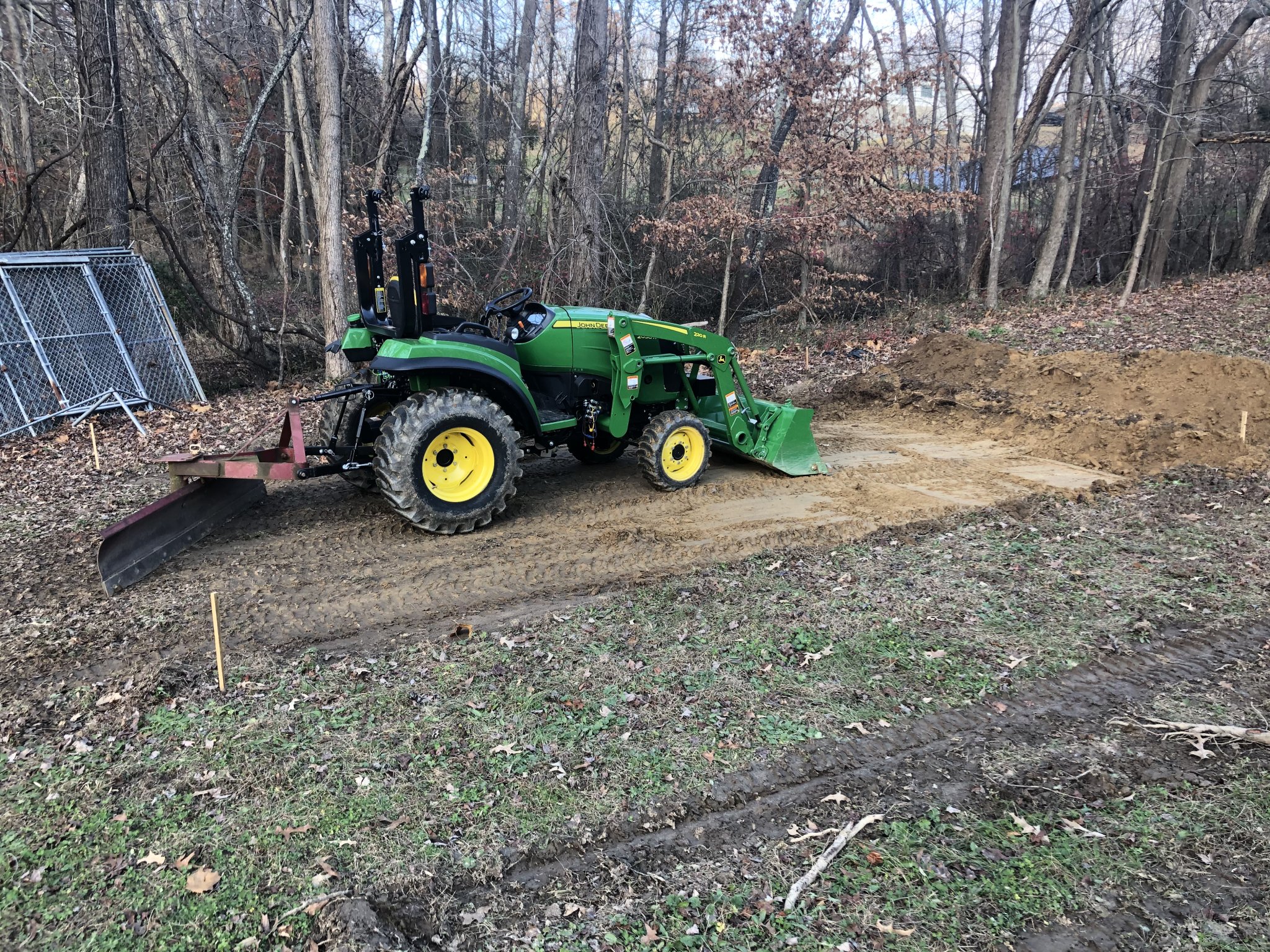

I am in need of a tractor to help me maintain and develop my property(3acre) and a larger property(20+acre) I hope to purchase later in life. My brother has let me borrow his green 2038r to fill in some canyons in my driveways and I feel like it is a good size. I also began to dig out for a tractor shed when I do get mine. This has been my first experience on a tractor and I feel like I’ve accomplished a good bit in 4-5 hours.

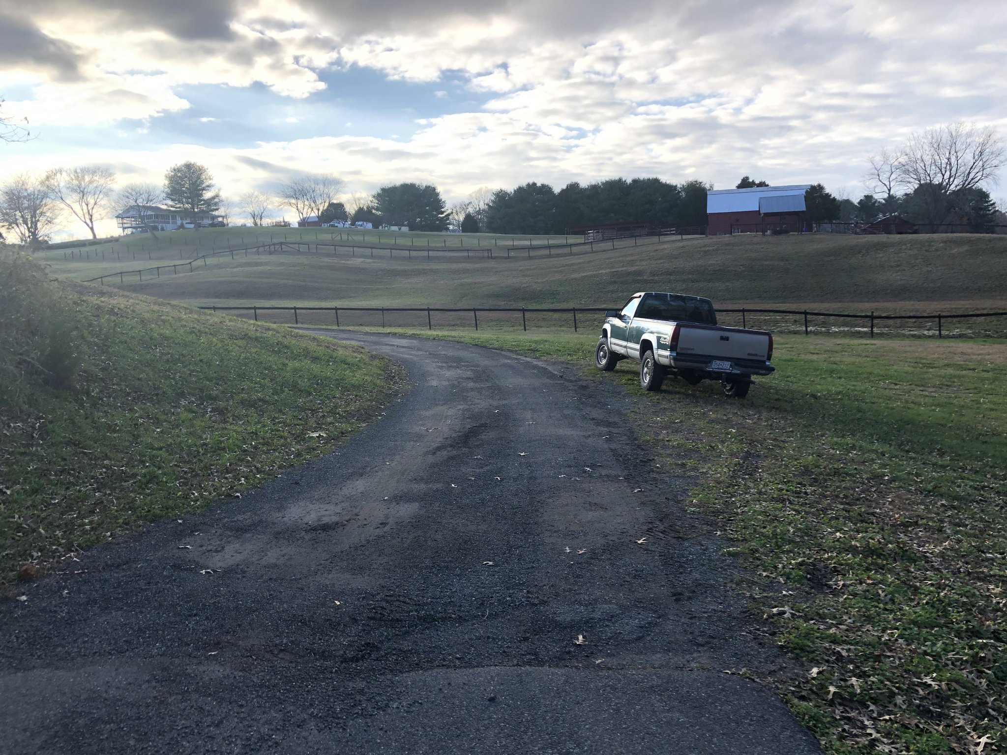

In the last picture I plan on using the tractor to dig out for a 60x40 or 50x30 shop/garage. I will also be making driveways on the property.
