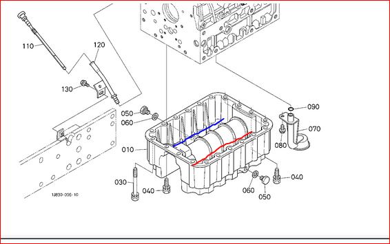

Thank you all for your replies. To those who mentioned I only drained from one drain plug, you are correct. That's exactly what I did but the manual clearly mentions to drain the oil, remove the drain plug. It does not say plugs (plural) or both. When looking at the bottom of the of the oil pan both drain plugs are at the same level and exactly opposed each other (left side, right side). the manual illustration indicates two plugs but again it says "drain plug". I don't get it... Is the oil pan designed with a divider in it separating the left from the right side thus creating a double reservoir and causing the need to remove both drain plugs to drain both sides in lieu of one?

Thank you to North Idaho Wolfman for providing a quick response to my last post and his clear resolution to my dilemma. As they say it was clear as the nose on my face and I got tell ya I feel a little %&$*!@& stupid that I didn't see the how the front drive shaft splits the oil pan. That was a $35.00 lesson in Kubota engineering.
