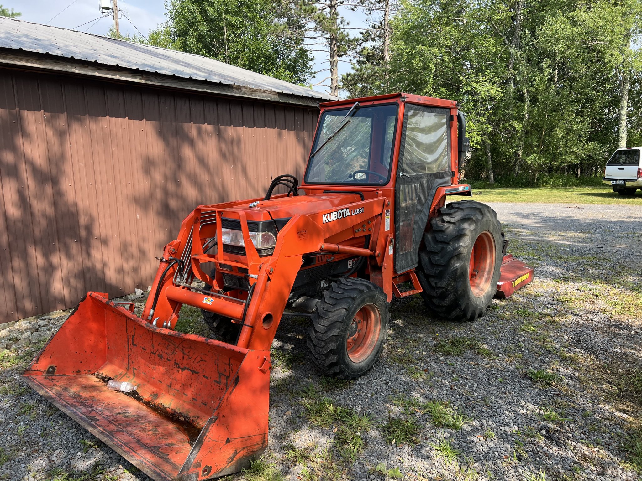

Rockshaft is broken as is rear differential and housing. Looking like $7500 to fix.
Is a L3710 with 800 hours on the clock worth fixing? Seems like a nice tractor but know nothing about if it’s a good model for Kubota?
Photos pre damage
WAS BANNED FOR NSFW PICS

If it is an ICC-regulated shipper, it should have insurance for such issues. If it were a local guy that just hauls as a hobby or part-time job, I doubt that he will have insurance. Was there a shipping contract executed?
Looking at the condition of the front bucket, I just wonder how much abuse that tractor has seen in the past. It looks like a good candidate for the Society for the Prevention of Tractor Abuse to be looking into.
Yeah my old man did have a bucket abuse problem! Lol jk,the bucket wear was from us rebuilding land cruisers. The rest of her is in better shape than the bucket!
