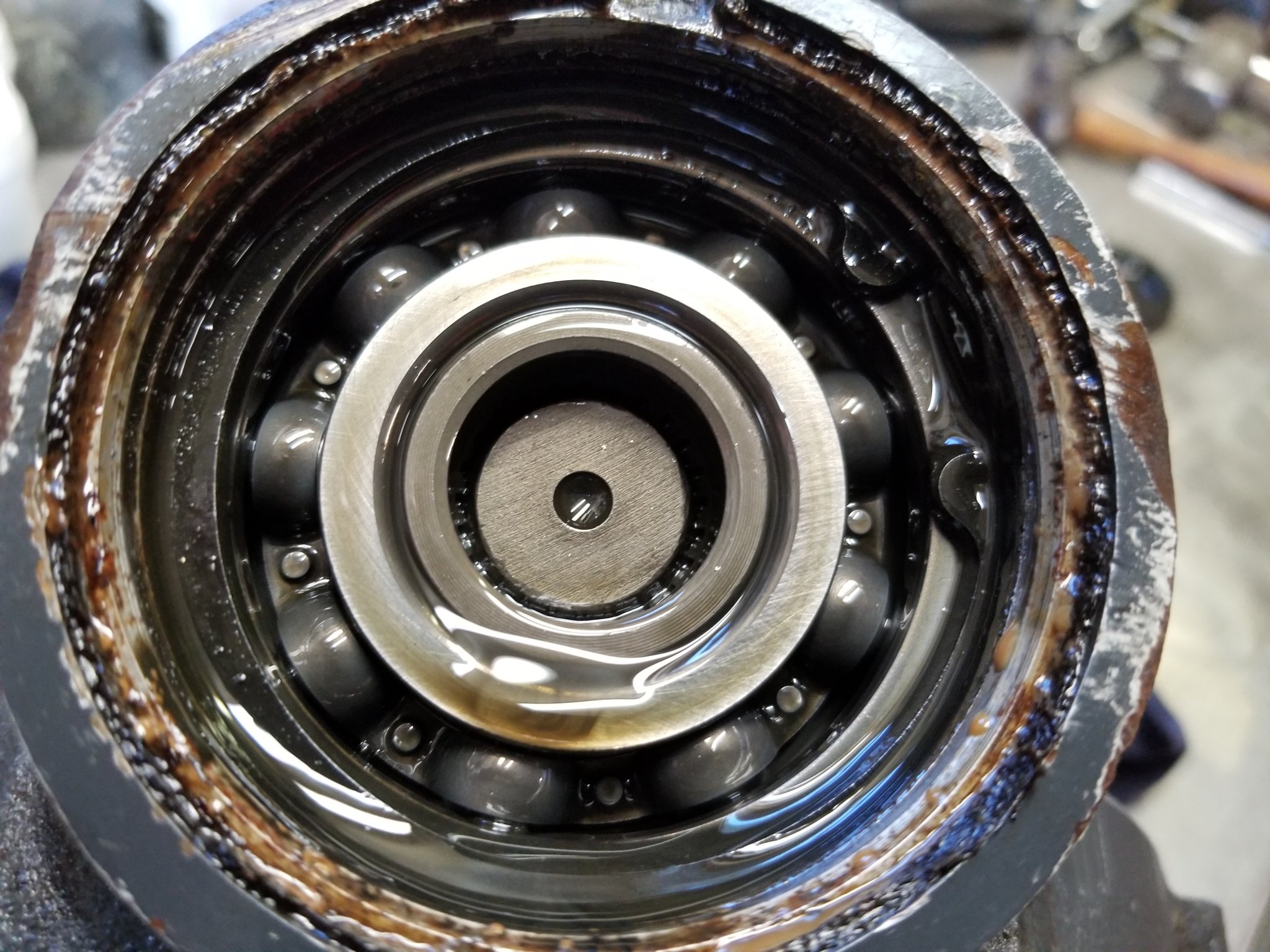

Got the axle assy tore down!
Found the two bearings in the cone housing to be worn/gritty.....replacng them and the seals!
