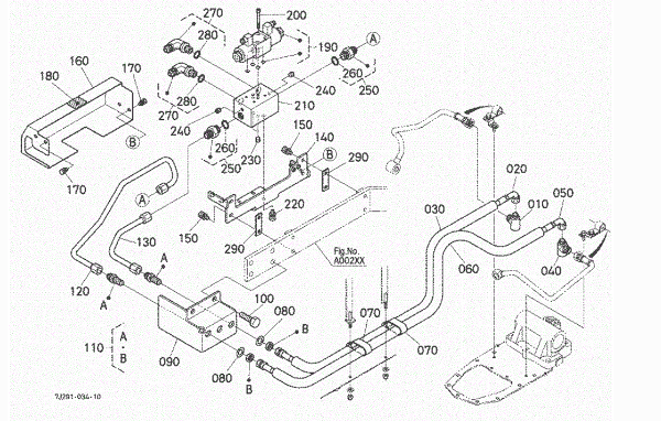

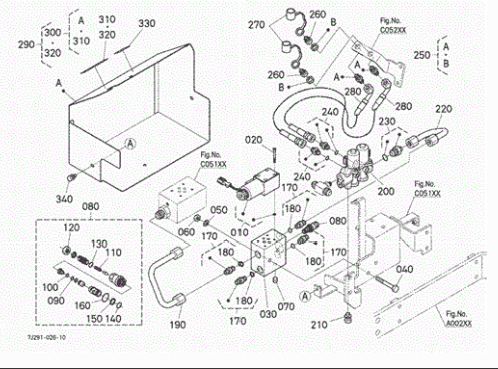

The parts diagram for the kit number the OP referenced does not show a relief valve in the 3rd function subplate.

I also revisited the parts diagram
FWIW the picture of the Kubota valve looks like a direct acting solenoid type like used in the LP kits not a piloted valve.

Thanks for your time and I believe these are the pertinent drawings for the L2265 kit.
As you can see from the C05500 component parts breakdown the 3rd function valve in this kit is not pilot actuated. It is the direct acting solenoid type with spring return to center so all the discussion of pilot pressures was a trip down a rabbit hole.
