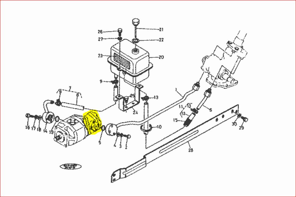

You have a very uniquely designed tractor, it was a model at the transitional stages of the newer tractors and they had not quite gotten up to speed on things.

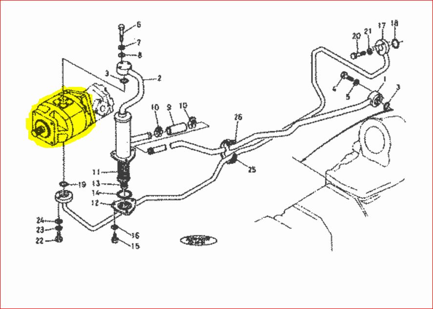

As such the Hydraulic pump is a 2 part pump and both parts are completely separate, the smaller rear pump is for the steering, and only the steering, and here is where it varies from most all other models, it uses it's own tank separate from the rest or the tractor, so the steering can work without anything else working.
Have you changed the canister filter for the main pump?

First pic is of Steering section and it's pump.
Second is of main hydraulic pump, #11 is the filter.

wolfman, I tried the knob under the seat, no good in the picture you sent the hyd line#26 is the one that chatters I loosened the line checking for air lock, oil came out any futher thought , thanks
28,689
5,114
#26 (larger line) is the suction line (in) so yes you should have fluid.
#25 (smaller line) is the pressure line (out) that's where you need to check for flow, just crack it, loosen the bolts and look for flow there.

wolfman, I tried the knob under the seat, no good, in the picture you sent the hyd line#25 is the one that chatters I loosened the line checking for air lock, oil came out any futher thought ,I revised my last post, this thing has me stumped is there a chance a valve some where is stuck? thanks
28,689
5,114
Since you have oil going into the back section, start looking at the pressure relief valve.
