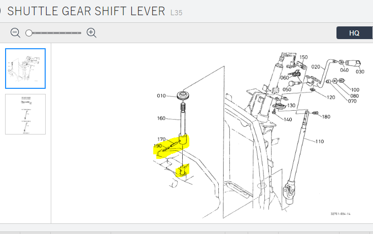

You never did answer my question, did you not do any work to the transmission, just a split for engine work?
It's not the clutch, that tractor doesn't even need the clutch for any of it's movement operations.
The main shifter has nothing to do with the forward and reverse unless it were stuck in neutral!
Did you reinstall both of the roll pins in the shuttle linkage?
The only other possibility is if the shuttle linkage inside the bellhousing got knocked out of the slot, and I really don't think that's possible.
If the roll pins are in it, and it won't shift out of reverse you will need to pull the roll pins (#170, #190 in pic above) and pull off the linkage (#160 in pic above) and see if the shifter shaft (#80 in pic below) in the bellhousing is flopping around without being in it's slot in (#40 in pic below), if it is then yep your in for a split to fix it.

@Billssa It's kind of easy to get the L35 shift linkage jammed up when reassembling the console, steering wheel and other things. Don't know what you disassembled when splitting.
My assumption is your tractor being "stuck in reverse" is right after assembly of the tractor and not after running it.
Have you looked at what @North Idaho Wolfman showed regarding the roll pins?
Have you looked to see if the shifter rod is engaged in the splines properly below the universal joint when moving the shifter - and that the upper F-N-R positioning is engaging properly?

Make sure that the splined shaft in the trans housing is in neutral, then ensure that the upper shifter is in the neutral position. Also it's easy to pull up on the shift shaft and mess that up while installing it.
You may have done this already - but it's a bit of a pain to remove all the pedals from the main pedal shaft (you'll need to knock out the roll pin on the left brake pedal) - but check and grease the needle bearings while you're in there.

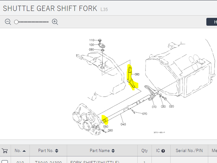

Take a peek again at Wolf's drawing above.
Note that the tang of part 80 goes into a slot in part 70.
The chances of the tang not being where it's supposed to be are low but again, note what Wolf says:
Part 70 moves in and out of the GST's valve body to direct oil to move clutches and stuff. If Part 80 and/or part 70 can't move, then you're "stuck"
You should be able to turn part 80 back and forth easily and feel part 70 moving in and out.
Part 80 does not rotate 360 degrees.
If it's stuck and not moveable - ouch - splitting may be required to fit parts 80 and 70 correctly.
If part 80 turns and you don't think you can find the middle (neutral) then turn it clockwise (which would be Forward) - Right? Then reattach the shifter shaft noting that it should be in the forward position.
You move the shuttle forward to go Forward which turns part 80 clockwise and pulls part 70 forward.
