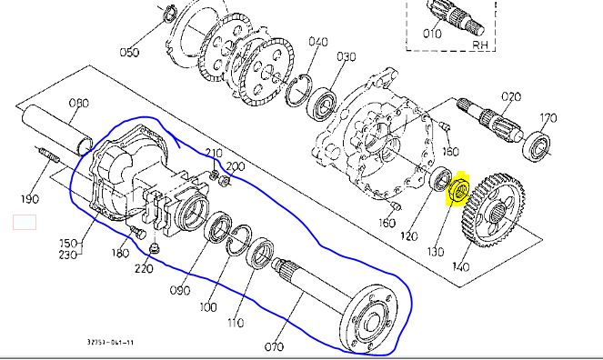

Hey all, Newbie here. Helping a neighbor with his L35 bargain he picked up from the coast. It appears the PO let the rear lug bolts get loose which in turn wallered out the lug holes in the rear wheels, which then wallered out the bolt holes in the rear axle flanges. These L35 Compacts have flanges on the outside of the axles that the wheel bolts to instead of wheel hubs that are removable. The question is: How much of a PITA will it be to replace these axles? Neighbor is willing to buy new ones and if I have to tools, I am willing to do the labor. Has anyone taken on this beast of a job? If so, what am I looking at? Dropping the rear drive unit?

Fairly easy job if you ask me, But I'm nutty enough to think a complete tear down is easy.
Just pull the cases (in blue) and unbolt the axles (nut in yellow).

Thanks for the reply. Said neighbor has already purchased new wheels and tires due to the fact that the old tires were completely shot and he suspected something amiss with the wheels. I do have plenty of room to drill out the holes and it would be necessary since at least one of them appears to have a new angle to it, and two studs are broken off in the flange, so I could wrestle with that repair or bite the bullet and tear down the rear drive to replace the axles. That would be the owner's call. But it gives me a couple options for him. Thanks again!
