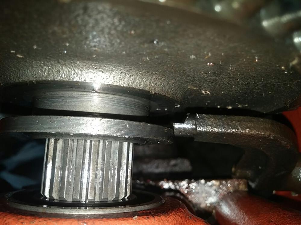

So I pulled my transfer case today and found that there is something wrong with my shift lever. It does not engage with the shifting slot on the driven gear. It is about 1/8 inch short of even engaging in the gear.

Today I was able to find a replacement gear box from a local company (Farmland Tractor in Tangent Oregon) that only set me back $450 (ONLY????). I'm posting pictures of the lever in my old unit and the new one.
