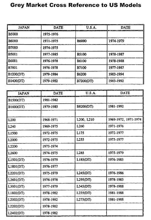

Russell is correct the L345DT is US, are you sure it is not a L3001DT?
Not sure about the 'cartridge vs spin-on' my L1500DT has a spin-on and
the PO who had it for 20+ years did no mods to it?
I just noticed (after 8+ years) this chart does not show
the US equivalent to the L1500 DT version?
I think it is the L225DT.
They look very similar with exception of the hood sides and possibly the exhaust
They do look very similar, I’m not sure what model this one is now lol. It’s got Japanese writing all over it so it may be the 30001dt. All the parts I bought were for a l345DT and they all bolted up fine.

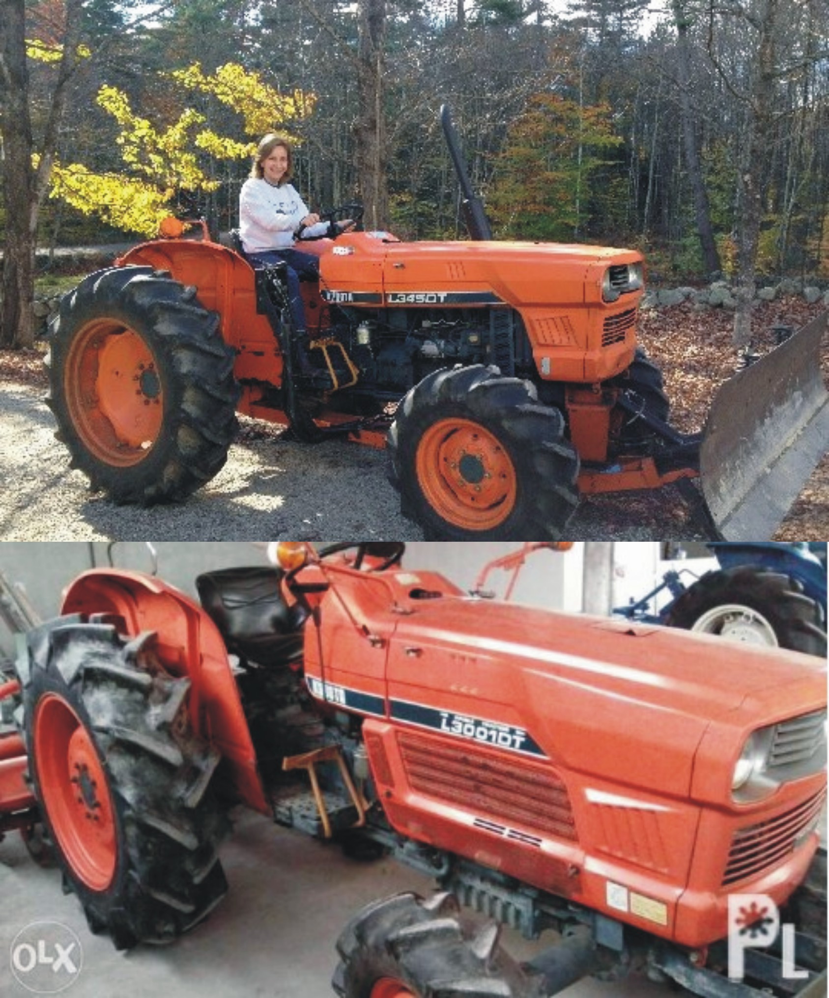

This is the pictures I got of it today.

It does look similar to my L185 in some ways but other parts are way different.
The levers on the left side are different and I only have one lever on the left. the one that bends over the top is similar to my high/low lever but it is shaped differently.
The levers on top of the transmission looks similar to the PTO (left) and gearshift (right). And I think the third lever in not on my tractor but is also not like the creeper gear that I have seen pictures of but I still think that is what it is.
The tires are normal Ag tires while some tires on grey market tractors are rice paddy tires with taller lugs and probably not Bridgestone brand.

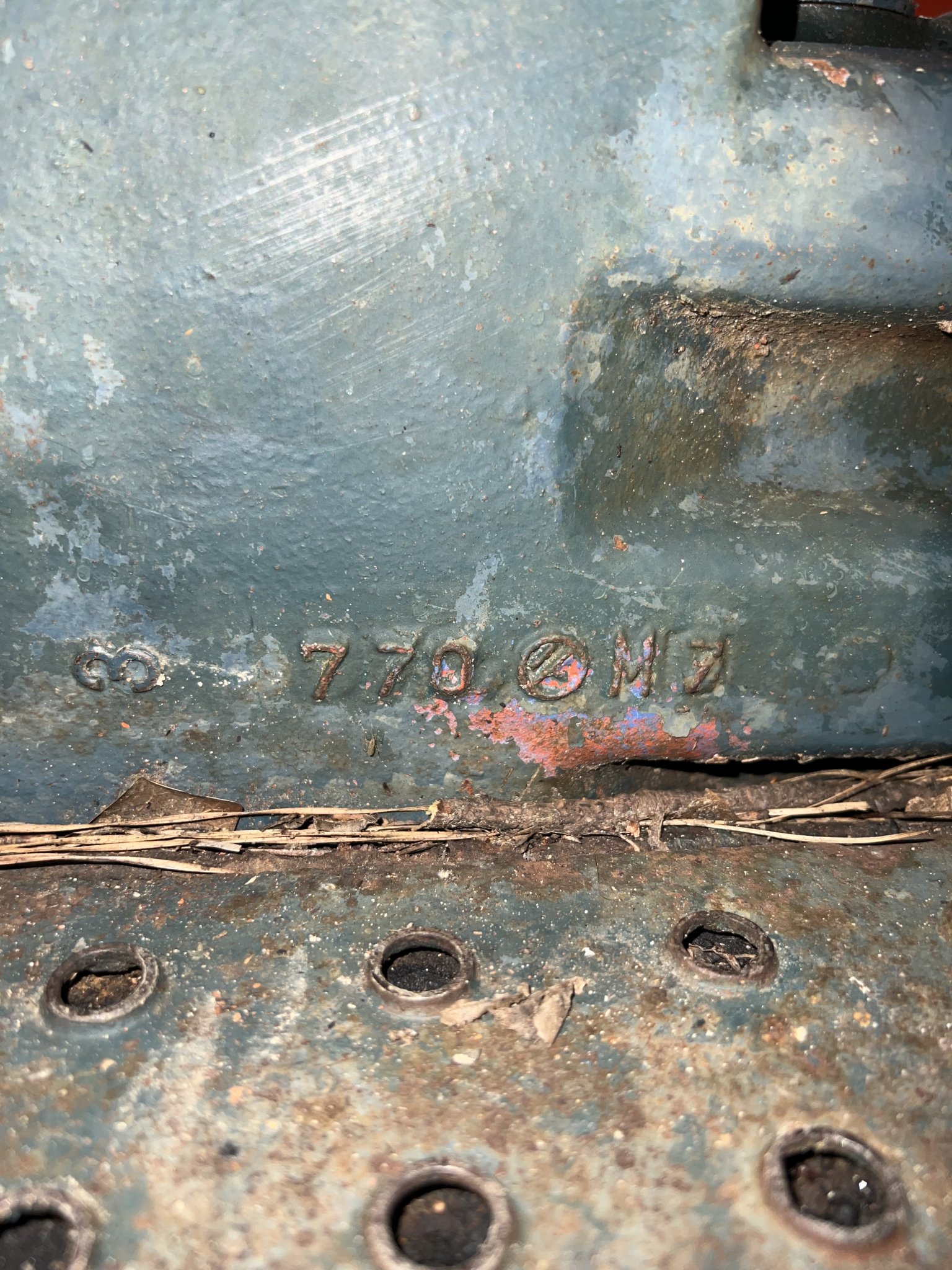

So what do you think it is, an l345 or l3001. At this point I’m aiming to the l3001. But honestly they share so much I’ll end up just calling it an l345. I do appreciate the info, I’ve asked around an no one has ever heard of a creeper gear. I like the fact that it has super low lol. My wife has some cosmetic plans for it. A color change is the biggest for her. Thinking about army green bed liner.
6,324
1,982
I really don’t know but if you can locate the serial number name plate that is riveted onto the transmission case then you will know.
I think it is probably the L3001 due to the Japanese writing you mentioned (only reason)
I would also lean towards the L3001, but if you are talking to a Kubota Dealer
IT IS A L345, or they will not sell you parts (generally, almost always speaking).
My local dealer still thinks I have a L175 and a L285, that is what I buy parts for,
for my 'illegal' L1500DT.
Just Sayin

I’m pretty sure it’s an l3001 at this point. From what I found it’s the same engine and transmission besides the creeper gear and a few other odds and end peices. There 90% identical I’d say.
