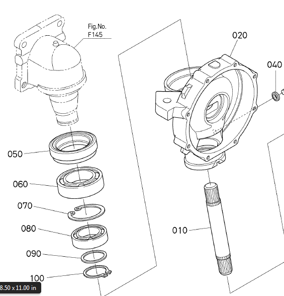

Front seals are pretty easy and parts aren't that expensive. Before you replace / renew the seals,, check the vertical play (slop) in the outboard assemblies by removing the wheels and grasping the end of the axle and lifting it. There should be no or very little vertical movement. If there is, the bushings will need to be replaced or the radial seal will leak fluid.

The seal I'm talking about is number 50 in the attachment. I have replaced a couple of these on both sides. I found a line of pitted rust on the mating surface of the knuckle fig 145, it looks like it could have been exposed to a salty environment. I chucked the knuckle in a lathe and cleaned up the surface as much as I could (not an easy surface to get to while the knuckle is spinning in the lathe). My next approach is looking into putting a sleeve on that surface if I can find one the correct size.
