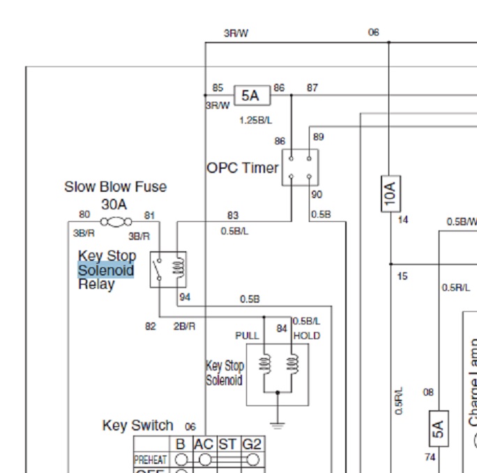

The Scottish version of the WSM shows both pull and hold coils of the stop solenoid wired together.
What is also apparent is the OPC timer's involvement with the solenoid.
If the tractor's wiring looks like this one, start by checking the 5 amp OPC timer fuse.
The Scottish wiring may not be the same as the North American tractor's.
