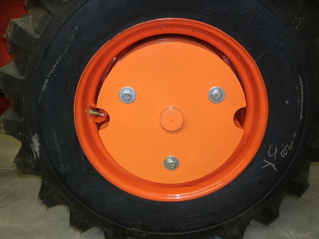

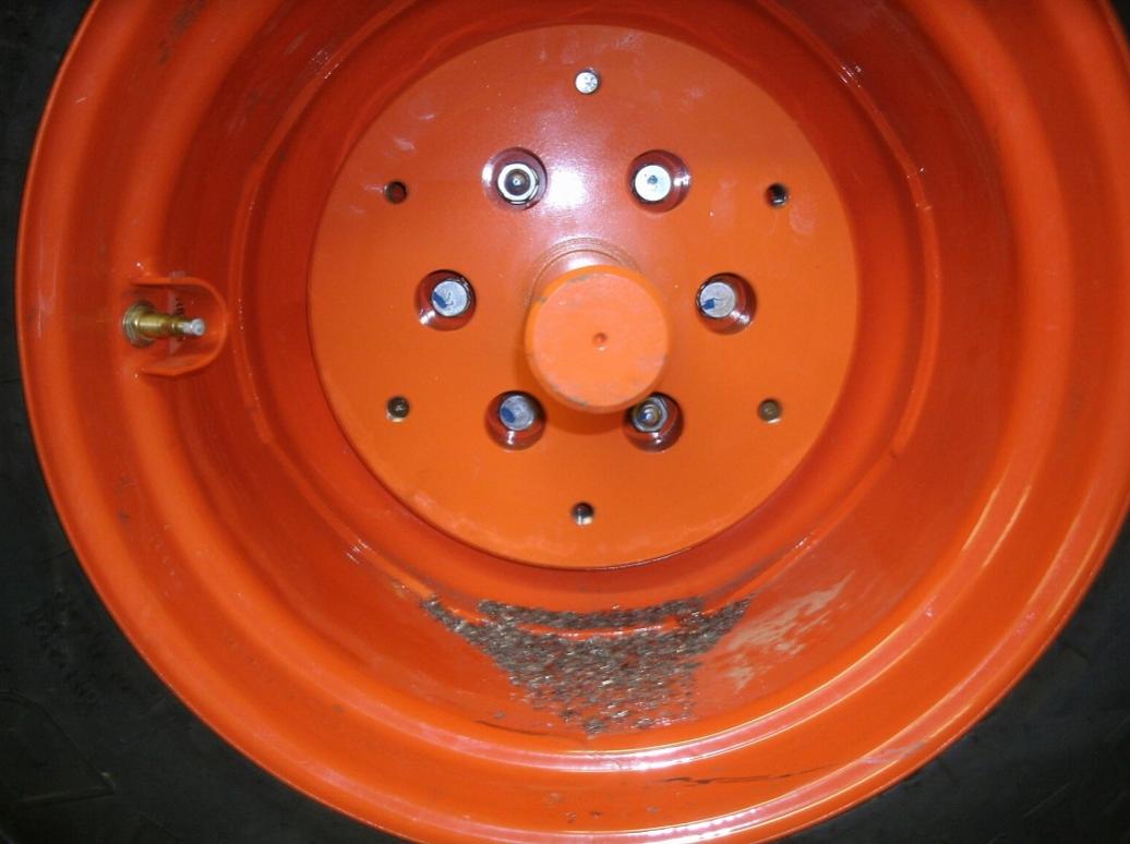

These tractors love weight on the back end. I have my tires filled plus I packed 500 lbs in each wheel. You'll notice the difference lowering the front end loader also. Much smoother without the back end doing the 'hop'.

Yooper, nice weights. Designed and built by Yooper Industries! How thick are the plates?
I've got eight 1"thick plates plus the 'spud' plate and shaft that the weights bolt to. The spud plate is 1-3/4" thick.

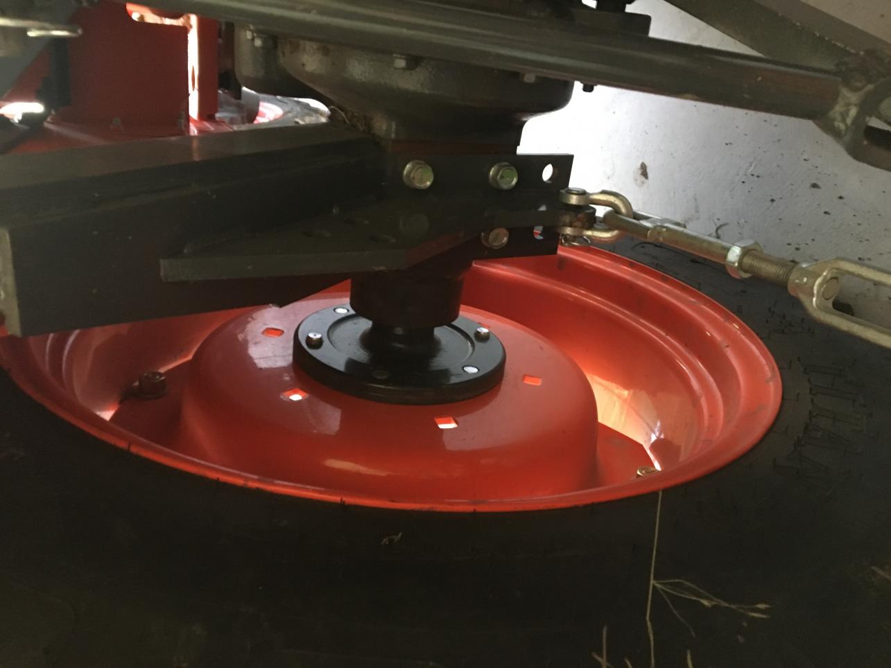

Looks like they are spaced out as far as they can go. Saw somewhere someone made concrete wheel weights. A ballast box would be the easiest but not most effective.
33,385
8,700
Thanks for the advise!! Please look at the attached photo. Is this as wide as my tires will go?
Nope, they are not all the way out, in fact they are far from it.
Jack up the entire rear of the tractor, and block it.
Take the outer bolts off connecting the rim center and rim outer ring, and swap the rim and tire right to left keeping the tread running the same direction as they are now. ;)

Yooper, Super Cool wheel weights.
Do you have any info posted on your spud plates in the fabrication threads?

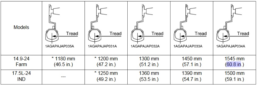

This is from the Operators Manual, it looks like yours are set for 51.2", you can set them to 60.8".
Hello,
You dont need spacers,
Leave the inner part of the rims as they are and turn the outer rim ring part with zhe tyres by 180 degrees, the swap left and right wheel,
Got it?
With this you get a tram width of 1500 mm or 60 "
