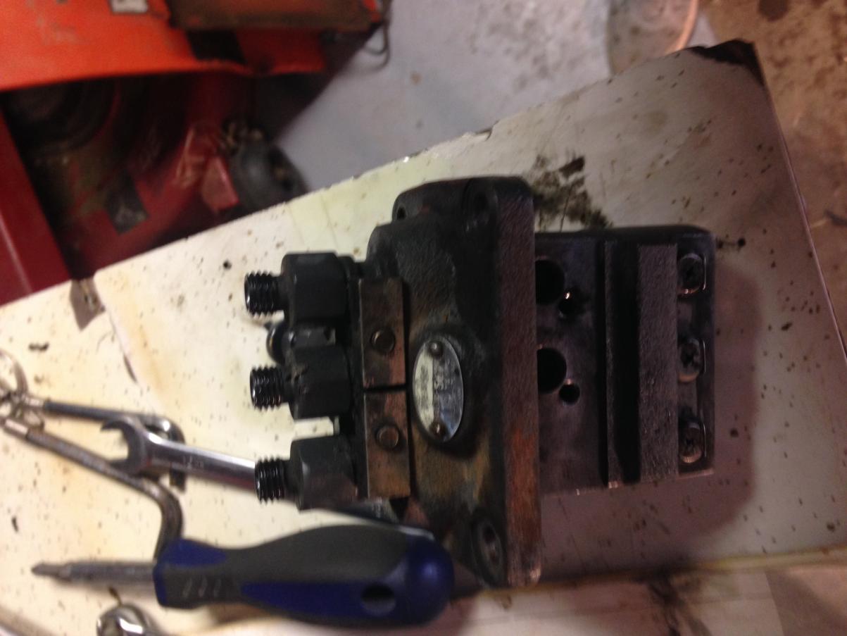

My delivery driver returned to town. He called and told me he had the now rebuild injection pump. They told him the orings were bad and they provided a paper with detailed instructions on how to refine the tractor. Total cost for the rebuild, $140. Much less than a replacement pump.

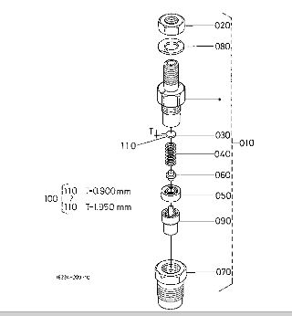

How to I test and or clean the injectors?
34,258
9,474
I really would recommend that you send them in and have them rebuilt properly and with test equipment, but, Yes you can pull the injectors and clean them, it's not that hard.
Here is what they look like on the inside, clean them with brake parts cleaner, or carb cleaner, and make sure they are dry when you put them back together.
The WSM should show you exactly how to clean them properly.
