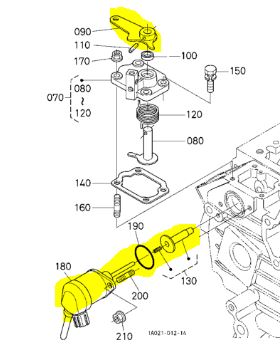

Have you removed the stop solenoid and see if it runs?
If the solenoid is failing it will cut off fuel.
Little worried about your comment "I removed all three supply lines at the injectors to make sure they were being purged of air, still no fuel at the injectors"
If you removed them they are full of air unless you bled them after you put them back on. ;)
Real simple, with the injector lines removed from the injection pump throttle open you should be getting a small fountain of fuel out of each of the pumps ports, if your not either your not feeding the injection pump fuel, or the stop solenoid is not working thus not allowing the rack to move thus not allowing fuel to flow, or you have run some trash into the injection pump and it has plugged up all the ports in the pump (highly unlikely).

There is plenty of fuel at the bleed valve on the injection pump when the starter is turning, but not a hint of fuel at the injectors.
Also check the the manual fuel stop is not engaged.
Lever on the top of the picture.
