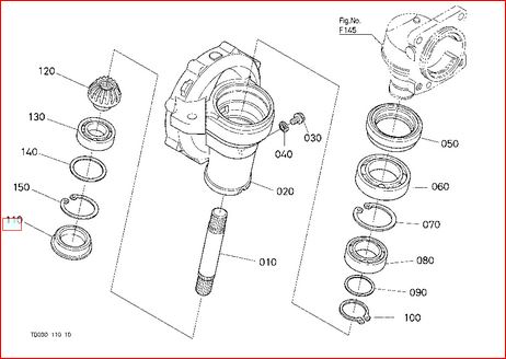

Yea I think we need better clarity where you are at:
State part group name and then number please.
Front Bevel Gear
Differential Gear Shaft
Front Axle Case
Front Axle

North Idaho Wolfman, the front axle case is where I am. Part no 20/front axle case and fig 145/bevel gear case are stuck together with parts 050/seal and 060 bearing still in there. I can pry them apart with screwdrivers and knock them back and forth with a rubber hammer but only 1/4". I even hit the tube part with a brass drift. It will move no further. It is soaking in Kroil.
32,919
8,378
Did you remove snap ring #70?
If you did, it's just a matter of the right thump.
On the front axle case rotate it side to side while thumping on the top and the back bottom (outward) of the front axle case, use a dead blow hammer.

Clarifying just to make sure:
#70 in an internal snap ring that attaches to the case
#100 is the external that attaches to the tube.
So did you remove both?

Wolfman, you are correct. I got the external ring off the hollow shaft. The bearing above is sitting on a ledge and must go up. The hollow shaft won't go through the bearing and I cant see split ring 70.
32,919
8,378
Use a pick tool to pull out the shim (#90) then the bearing (#80) then that should let you see and remove (#70).

Wolfman, I think I see my problem. The bevel gear case needs to be removed before I can access the seal 50, bearing 60, snap ring 70, and bearing 80. I probably flared the end of the hollow shaft of the bevel gear case when I hit it with a brass drift pin trying to get it out. Now it won't pass through the inner race of bearing 80. Now I think my only shot is to bring it to the dealer and hope they can press it out unless you can think of anything else.
