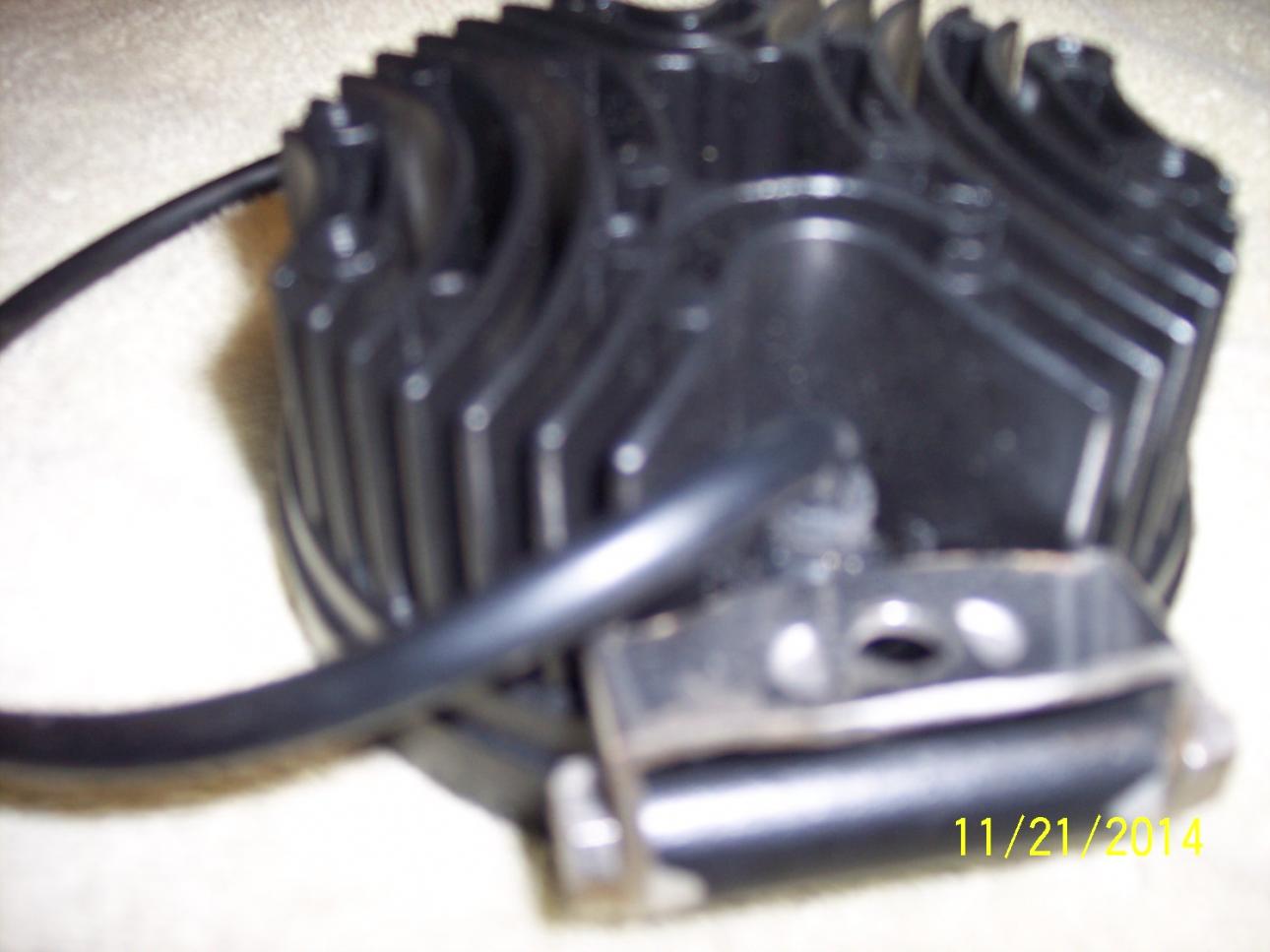

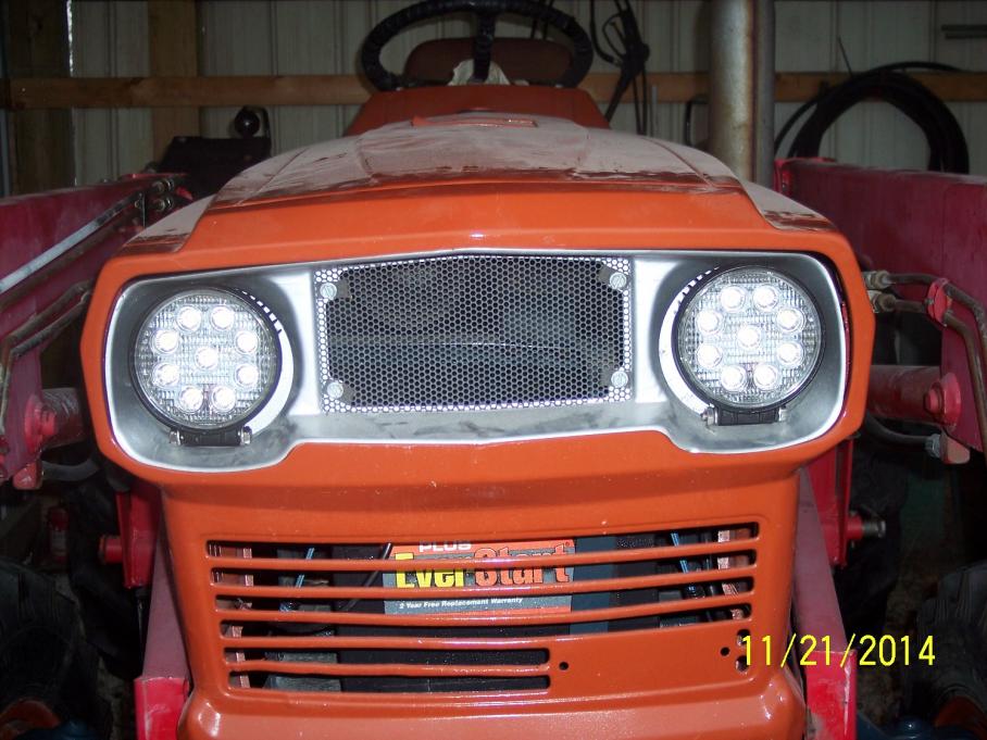

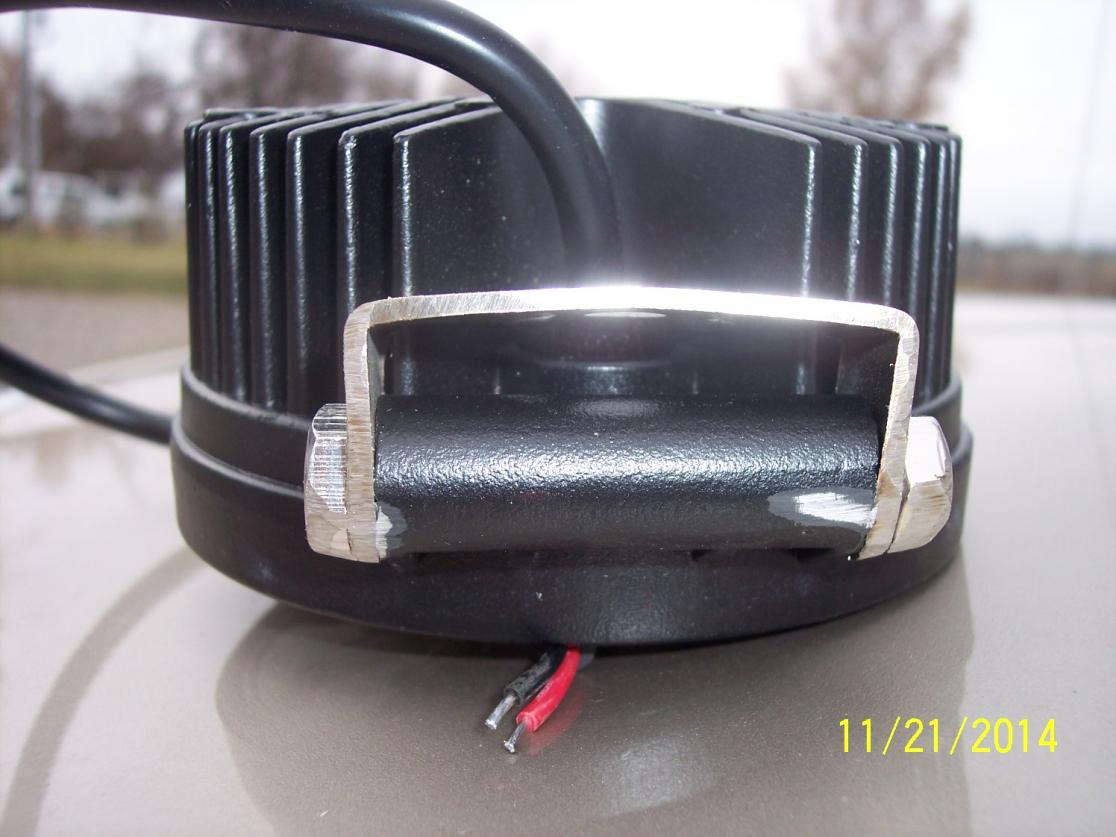

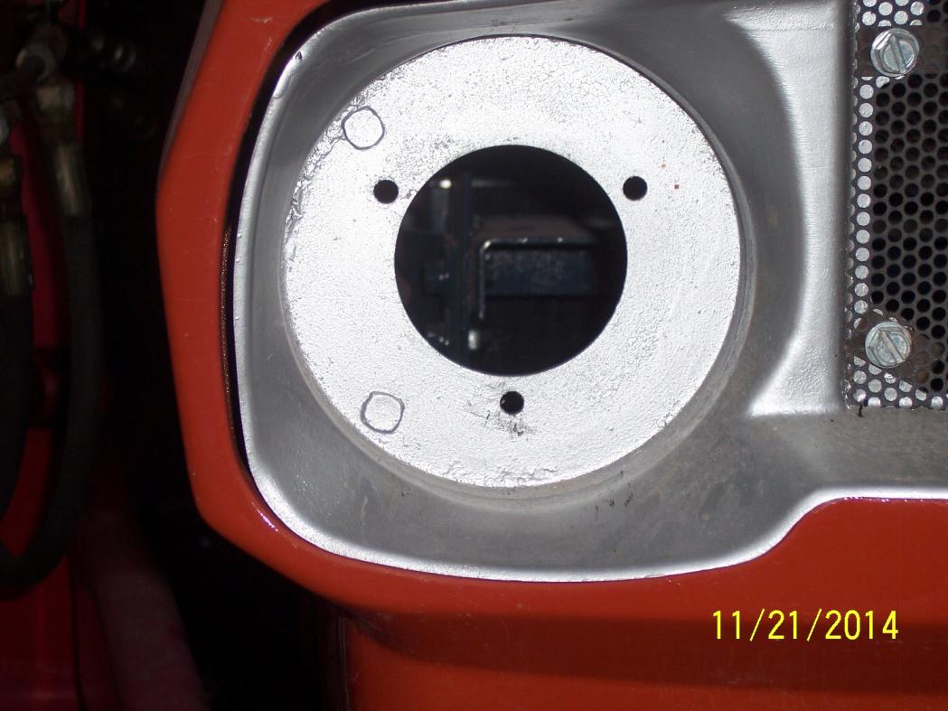

Daren, you wanted to see the headlights I used. I got them off of Ebay. 27 watt, I think. Alum housing with metal brackets. I modified them to fit the holes because that's all that was there. I made it so the bolt would fit in the bottom of the three holes. I took a die grinder with a tapered cutter to simply move the hole down some as I enlarged it.
I had to modify the mounting bracket, but an angle grinder and 10 minutes gets it done.

Those look great!!!!! Really nice clean look with it too. I like those better then the ones I put on mine. Nice job on the tractor:D

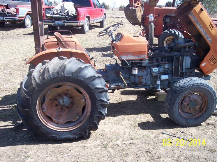

And I thought I bought a "banged up" tractor!
Good for YOU!. Its wonderful to see someone with patience and ingenuity take on a restoration to bring back what is actually a perfectly good machine. Too bad it sat out so long. It would have been nice to have gotten ahold of it a month after the fire.
Great shots of the "crispy bits." Can't wait to see her all done. Keep the pictures coming.

Ray, I understand what you're saying, "Too bad it sat out so long. It would have been nice to have gotten ahold of it a month after the fire." however, the price dropped dramatically with age, I'm sure. The damage was done and then they had to set and look at it for a long time! I also got a 6' Woods brush mower that they no longer needed.

I was wanting to see how much damage was done to determine if it was a workable tractor or just parts. If you look at the picture of the headlights you can see the top of the hood. Ripples here and there. I got them worked out a little bit but I just wanted a tractor to work. I can put up with 85-90% perfect. Mechanically excellent, pretty....much less so. The loader is a Massey 1246, designed for a 30HP Massey tractor. Built by Woods. A Massey 30HP tractor is much shorter then a 30 year old Kubota. It required some modifications and adjustments to get it to fit. Nice joystick controls also. Found it in Beebe, Arkansas on Ebay.

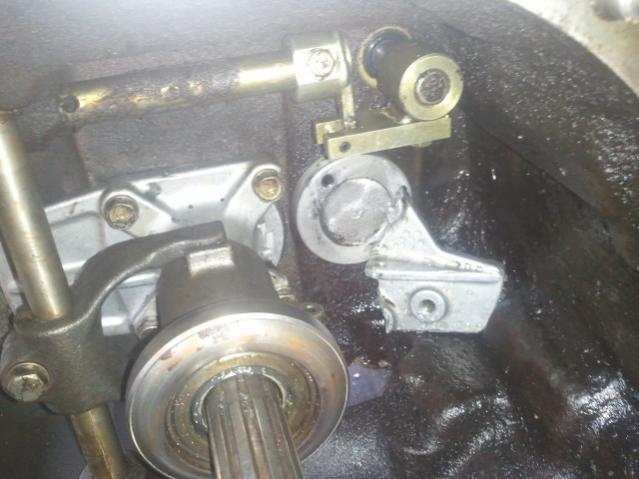

Try picking one up that some "genius" mechanic had gotten ahold of, and preceded to destroy the insides of the transmission!
It really helps to put the right parts in the right places before you tighten the bolts up!

It's a GST Transmission, and there are over 90 O-rings in it. :eek:
Yea leaving even one of those little buggers out was a bit of a concern! ;)
And yea it was a little bit of a challenge but it runs like new now, and all for the fraction of what it would have cost me if I bought it running! :D

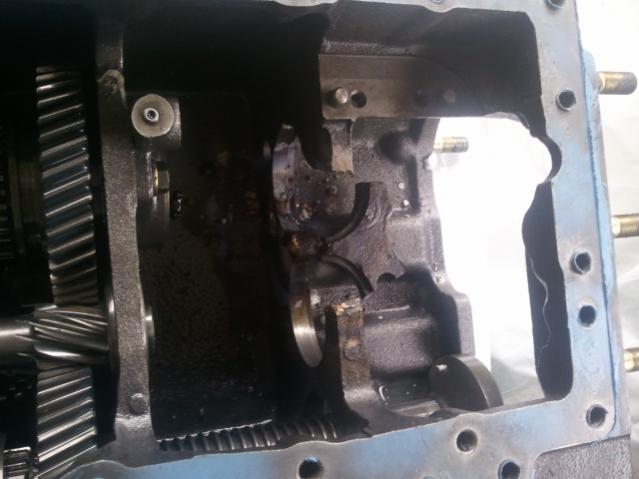

How did you fix the broken gear box casting? Swap over to a new unbroken case? Or a few tubes of JB Weld? :)

Funny story about the case:
I bought the tractor only after doing some research "knowing" I could find a new case, only after getting it home did I get the call that the case I was buying was broken too.
So I too also know my limits, My welding skills and my welding equipment are not up to the task! I took it to a welding/machine shop in town. The best $125 I've ever spent on a welding/ machining job, everything went back in perfectly!

Wow.
Precision welding on a casting is like the pinnacle of welding I hear. Getting the gear train centers to line up takes verrrrrrrry careful work.
Good for you!

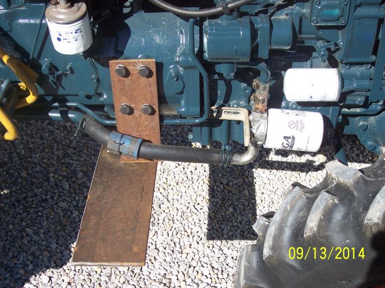

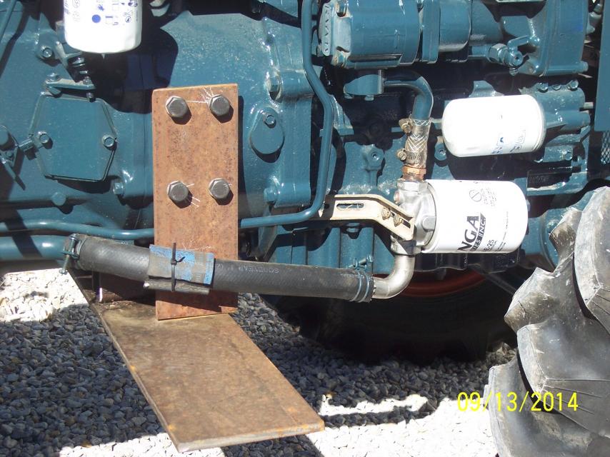

Here's a picture of the original hyd. filter. Then the new improved version. North Idaho Wolfman directed me to this setup. The bracket was out of my "bone pile", a support for an air conditioner. I will eventually improve that.
