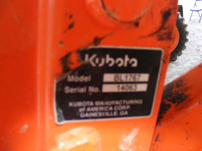

If you are still interested in a pin on Quick Hitch, the Kubota BL1767 (3J055-36104) is the one that fits a L3010 with a LA481 0r La482 loader, I just got mine this week and paid 279.00 from the Kubota dealer, plus I have a list of what other models this will fit also. Dan

With the pin on quick coupler that Bulldog pictured and VTmaple talks about, you use the original bucket (and other attachments) pins to hook on with without any modifications.

BAP, you are exactly right about no mods required, another plus in my book. I like the fact that it has no moving parts to wear out unlike the SS type. I have used both types and IMHO the Kubota style QA beats the pants off a SS type QA.
