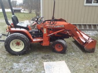

Here is a side view. Used it for a hour or so,it's stronger and faster than I expected,it sure will come in handy!
14,716
7,240
It looks good. The loader towers are in a good location and the bucket looks like it's not too far out or too close.
