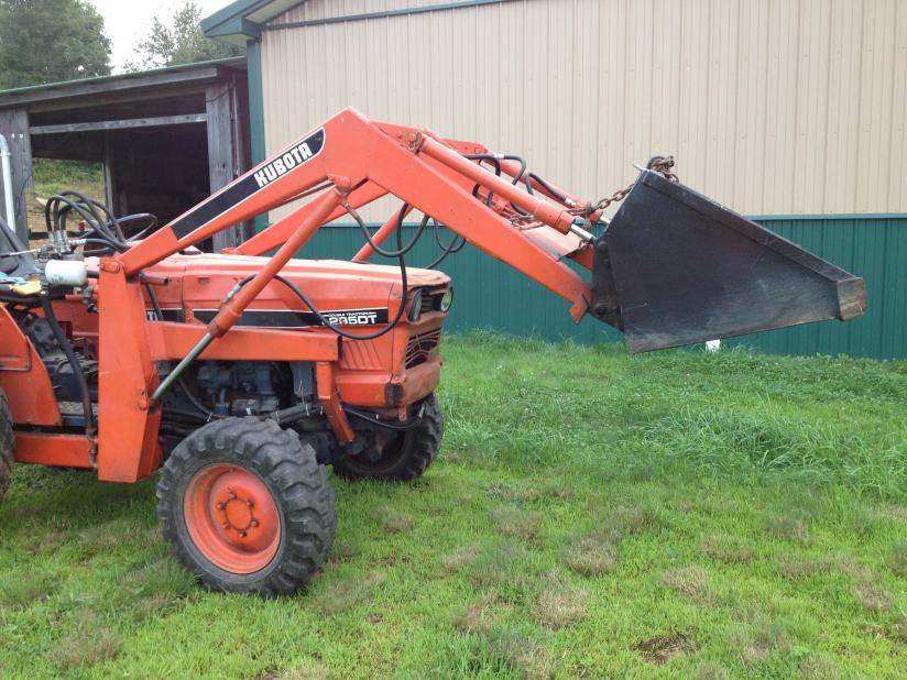

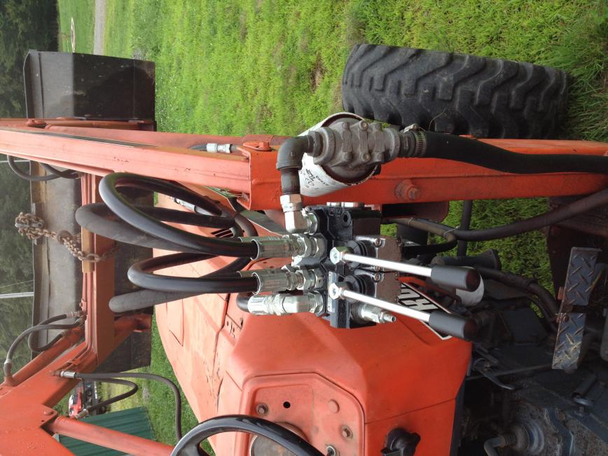

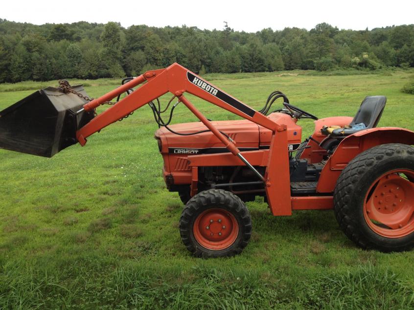

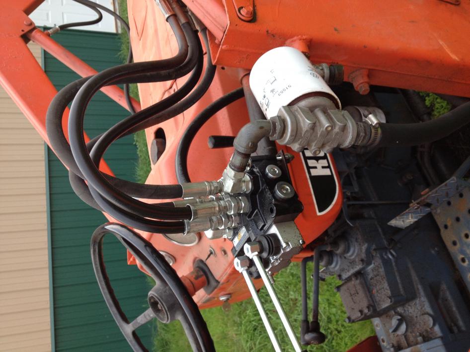

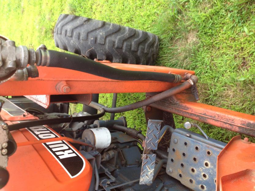

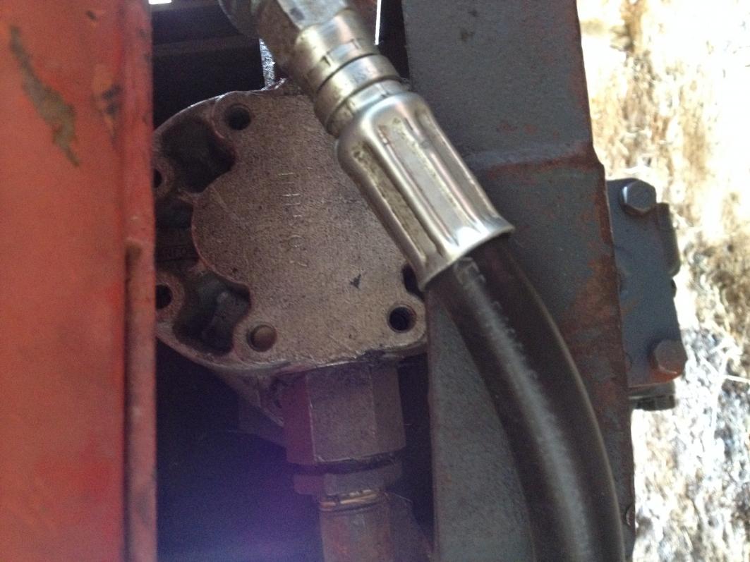

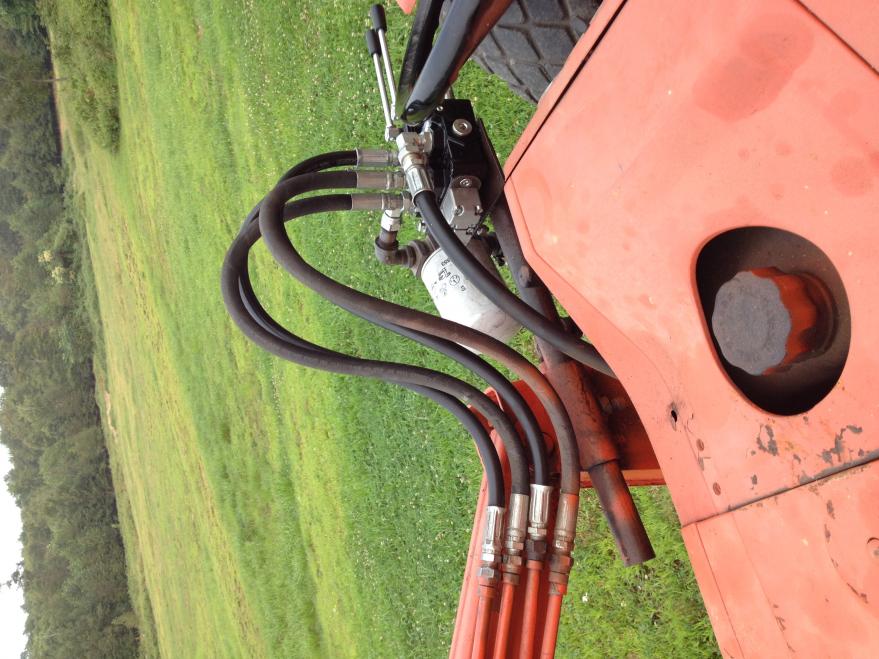

Give a picture of the loader, the controls, and the plumbing.

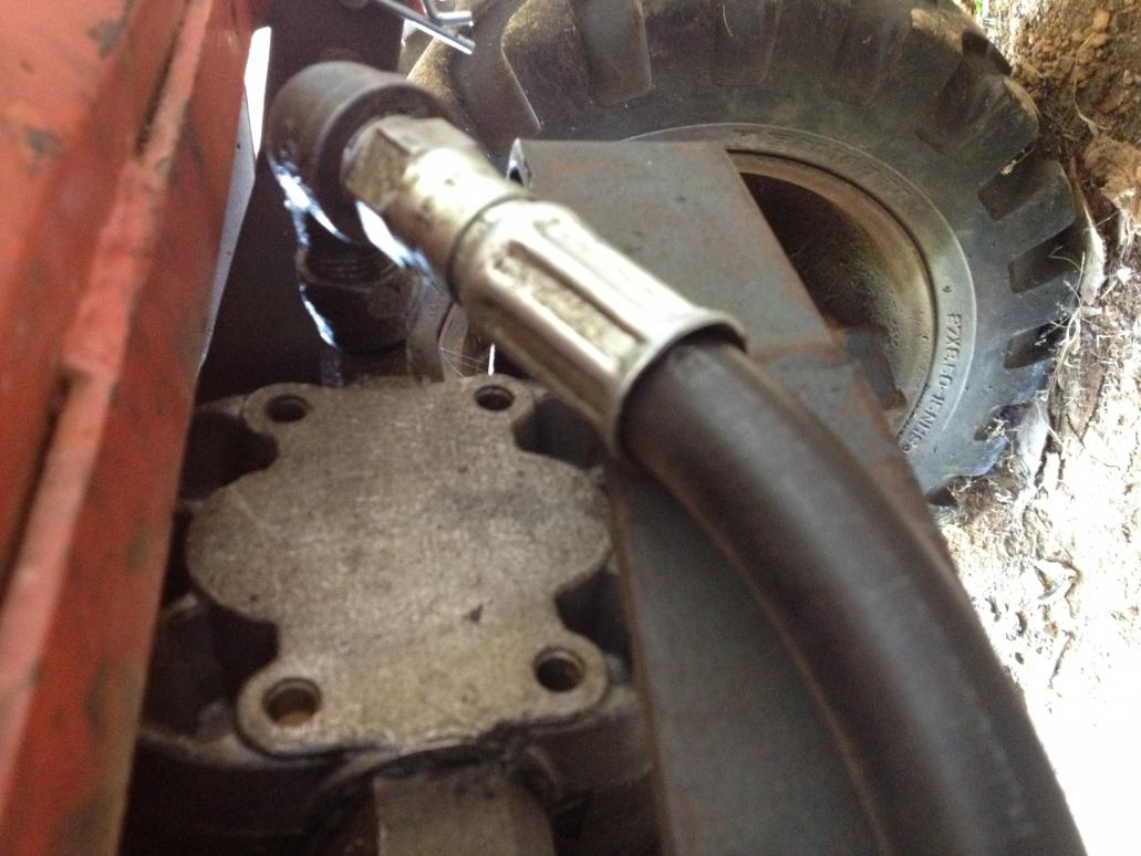

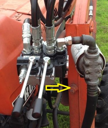

The tank breather is above it, from the looks of it the right bucket and boom cylinders are leaking, plus the tank return line or suction line at tank appear to have a lot of old oil there. The pressure line from the pump looks shiny, can't see if it has leaking oil, check all lines and fittings.
