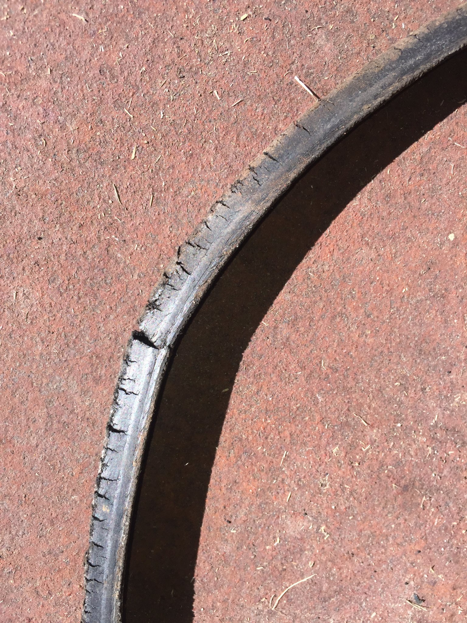

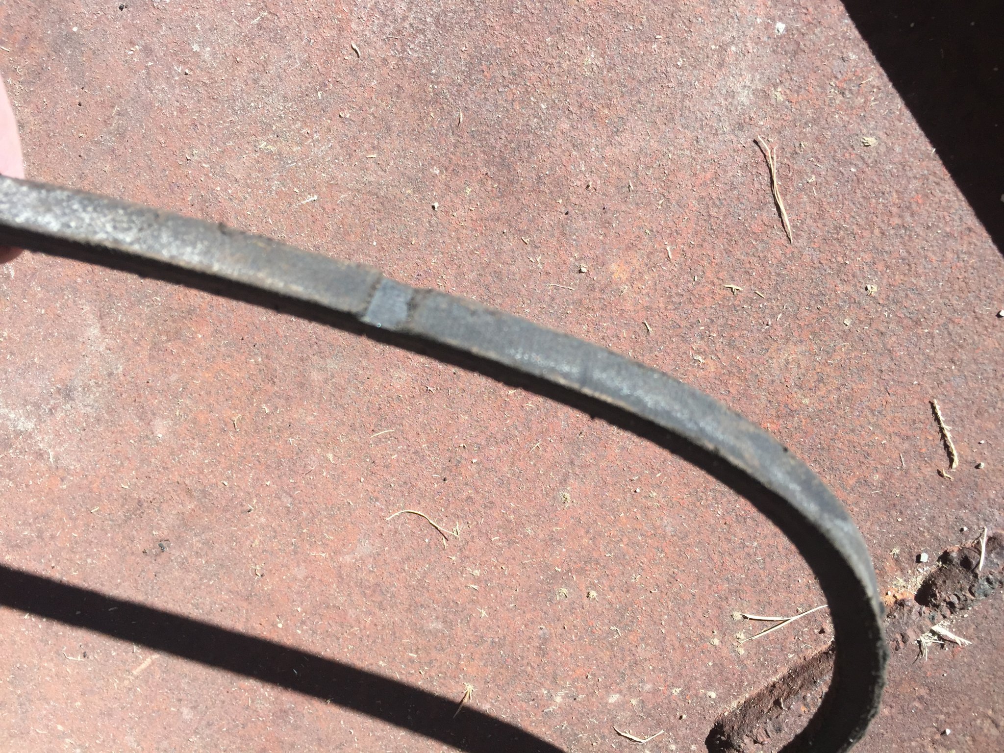

SOOO figured out why my 1975 vintage L285 fan belt looks SO BAD!!
During my water pump change I planned to change all the hoses and fan belt and thermostat (more on that in a min)
I know the fan belt is at least 25 years old and maybe older 30? the tractor is 45 years old but cant imagine the belt lasted that long!
The reason it is SOOOO OLD is because in order to change it you have to disconnect the hydraulic pump which is directly driven by the crank shaft. The belt goes around the crank pulley so will be figuring that part out this weekend.

... I’d strongly recommend replacing with only an OEM v-belt.....
Kinda cut n pasted you post and FYI I did get the OEM belt to replace the one that is installed. Pretty sure the belt installed is not OEM as the alternator has almost ZERO adjustment for tension (meaning the belt was short) the issue I have is I think I have to remove the hydraulic pump to change the belt; YIKES!!! Gonna tackle this repair this weekend... MORE to come!!

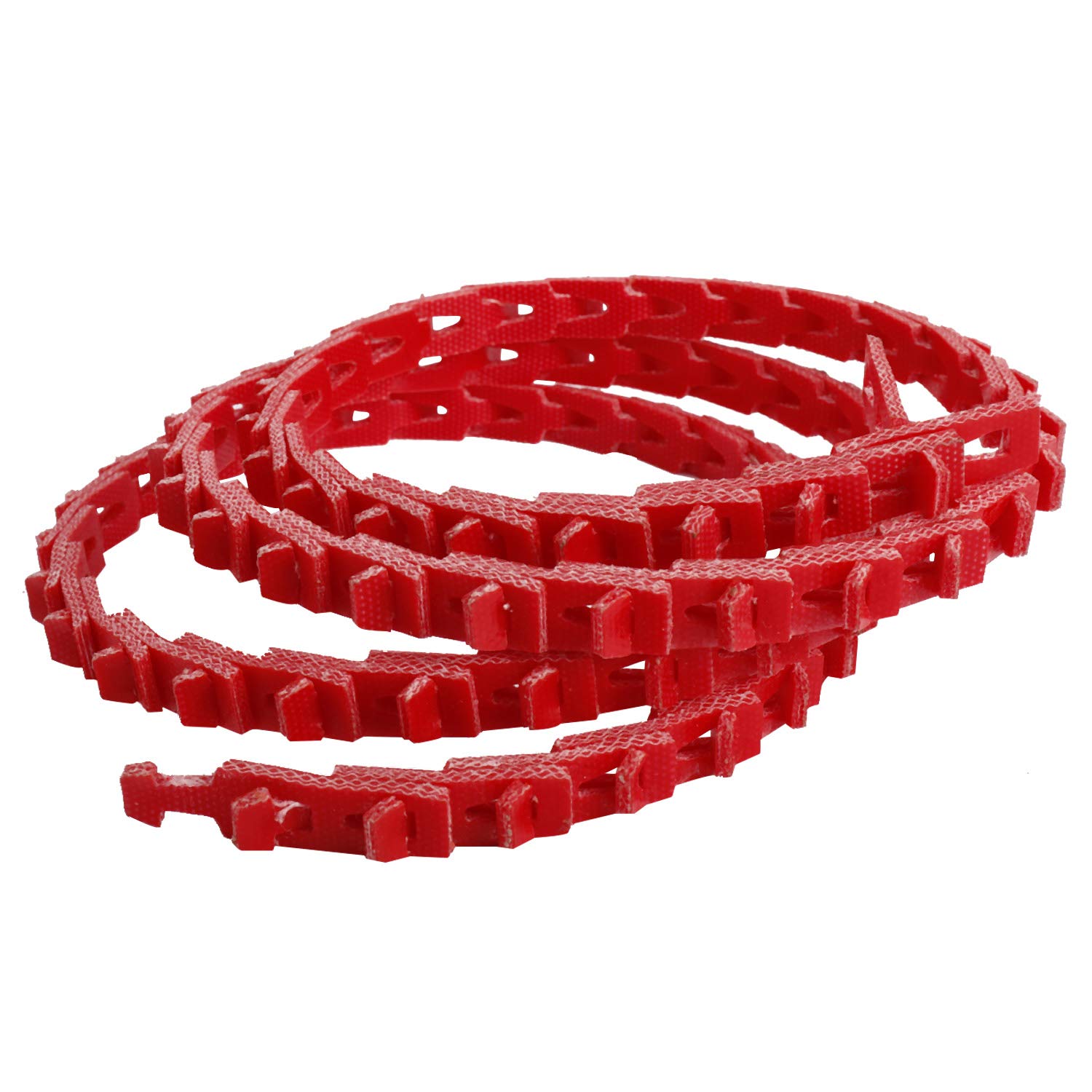

Anyone ever use a belt like this?
After looking at the front end of my L285 in order to replace the fan belt I will have to remove the hood, battery, hydraulic pump and some brackets which just does not sound like fun... Then I have to hope the drive spline to the pump will separate so I can get the
belt around the crank pulley...
I have read a few reviews where this type belt was used in an emergency situation but ended up staying on the vehicle (one was a tractor) for a very long time.
This would save me a lot of tearing apart stuff which has the potential for requiring more parts (hoses etc)

View attachment 52609 Anyone ever use a belt like this?
I have used the Fenner Power Twist belt shown in your picture on some metalforming machinery where the belt was exposed to an oil mist that would dissolve "normal" belts in a few weeks. They work great but are pricey...well worth the investment and I also used them on industrial applications where disassembly of the equipment was a hassle. They can be threaded around a pulley with limited access, joined together and then tensioned as usual. They ARE directional, so make sure that they are running the proper way according to manufacturers instructions.
I also use them in triplicate on my Jet cabinet saw...smooooth running! I can balance a nickel on edge on my table saw while it's running. Harbor Freight sells a knockoff of the Fenner Power Twist but it's not made nearly as well.

THANKS mcfarmall!!
I did decide to remove the hyd pump and shaft to change the belt but next time may be different. Hope this belt lasts 20+ years too kuz I will be living at the beach by then!!
