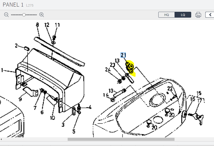

Following up on this, as I’ve had time to do the following.
  1. I took the cover off the regulator and tested it. Contact arms inside were free and tested using a test procedure from the local Kubota dealer. Checked out good
  2. Replaced original negative battery cable with new sealed coating one going to a spot on the frame that I sanded down to get a better ground.
  3. Removed dash panel to check into Glow plug indicator. Found one nut loose on the back side, so more than likely the glow plugs were not working 100%. Now whenever I cycle the key ignition to the glow plug position the indicator heats up and glows red. Glow plugs are now measuring 10VDC.
  4. Fan belt was indeed loose. Tightened belt.​
After doing all of this the engine doesn’t seem to turn over any faster so I’m thinking to have the starter rebuild or replace it. It does start easier than before with the glow plugs working again, hopefully it stays that way. The charging light on the dash only stayed lit for about 30 seconds after the tractor was started. I think the fan belt being loose was the problem for the charge light staying lit. The battery with the engine running at idle was at 12.8VDC. At half throttle 13.1VDC. At full throttle 13.4VDC.
Looking for recommendations on fan belt brand and part numbers for a L275. Current belt number are worn off and belt has some good cracks in it, it’s time to replace.
Also looking for some pictures of how the ROPS is secured to a L275. Person I got the tractor from had removed it but kept it. Whenever I got it he gave me what he had but I think some parts are missing.
Thank you again for everyone’s help and suggestions!! -AJ
