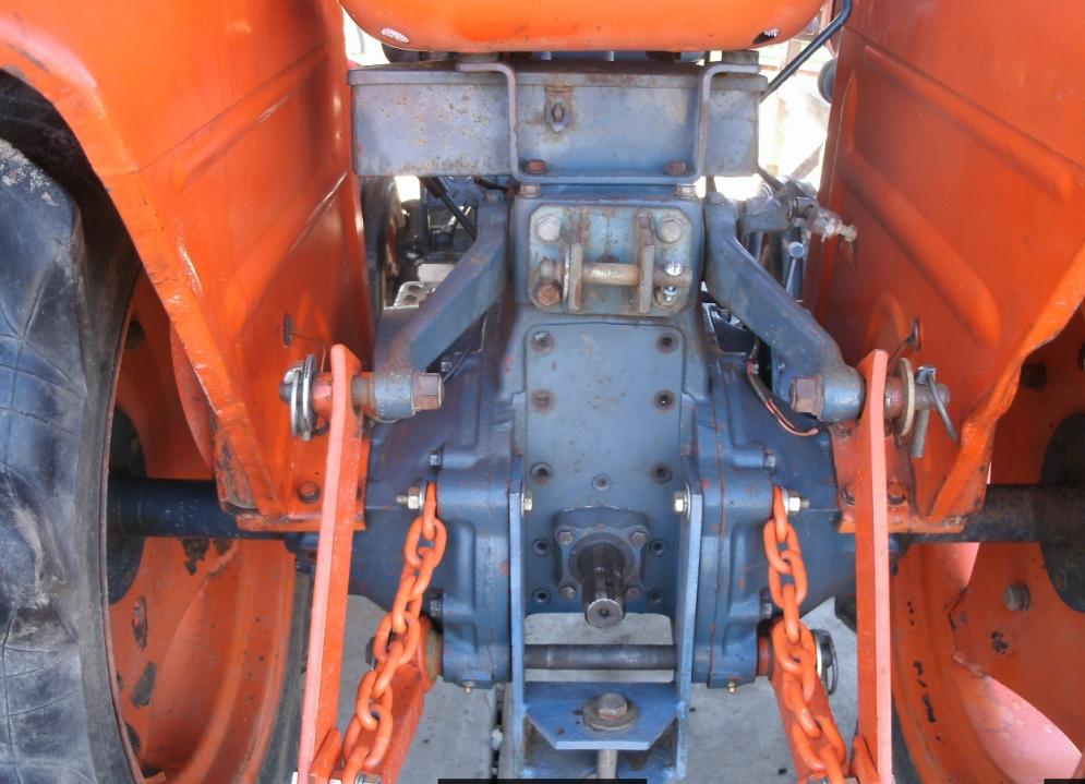

I did have to drill the holes out a little on the front and back top mounting plates there to get the bolts to line up and I think I read somewhere someone else had to also.
Glad I read this as I was wondering if it was something I did. The recommendation to leave everything loose until it is all hung and bolted up was a good one also as there was some maneuvering to get it all slung onto it correctly with some messaging of the holes...:confused:

Just got mine after spending some time with a great lady named Annette at Kubota. Took some emailing and some serial number pictures, ordered my kit from a GREAT dealer and they drop shipped right to my shop. The kit for my L175 is the SFL-22. I am not familiar with the SFL-27 but the kit came with the PTO cover also. A 12 x 1.25 tap is a must for opening up the lower stud threads.

Locate the holes in the tractor and clean them up with penetrating oil and run the bolts in before you start!
