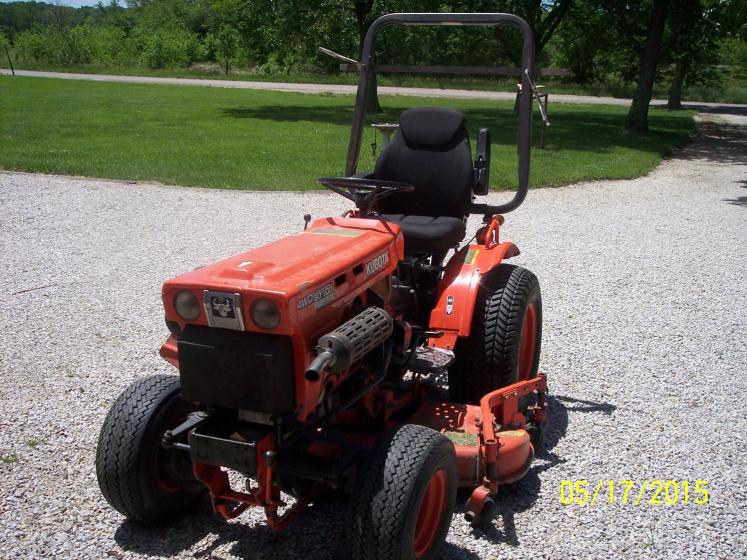

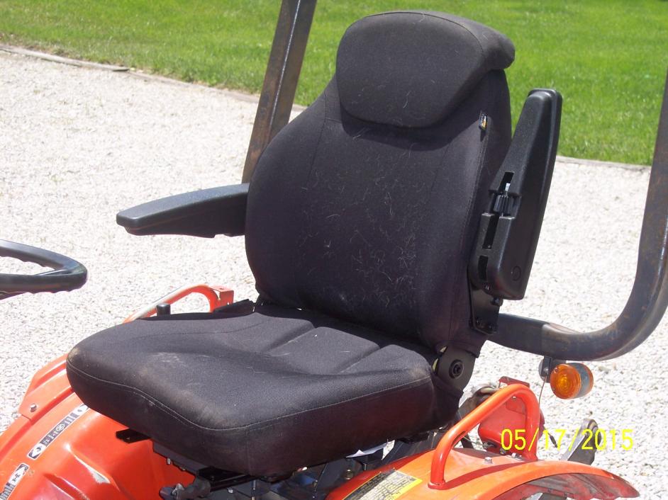

Here's an aftermarket seat I put on a B7100. I removed the entire sliding mechanism and used what was on the seat I bought.
