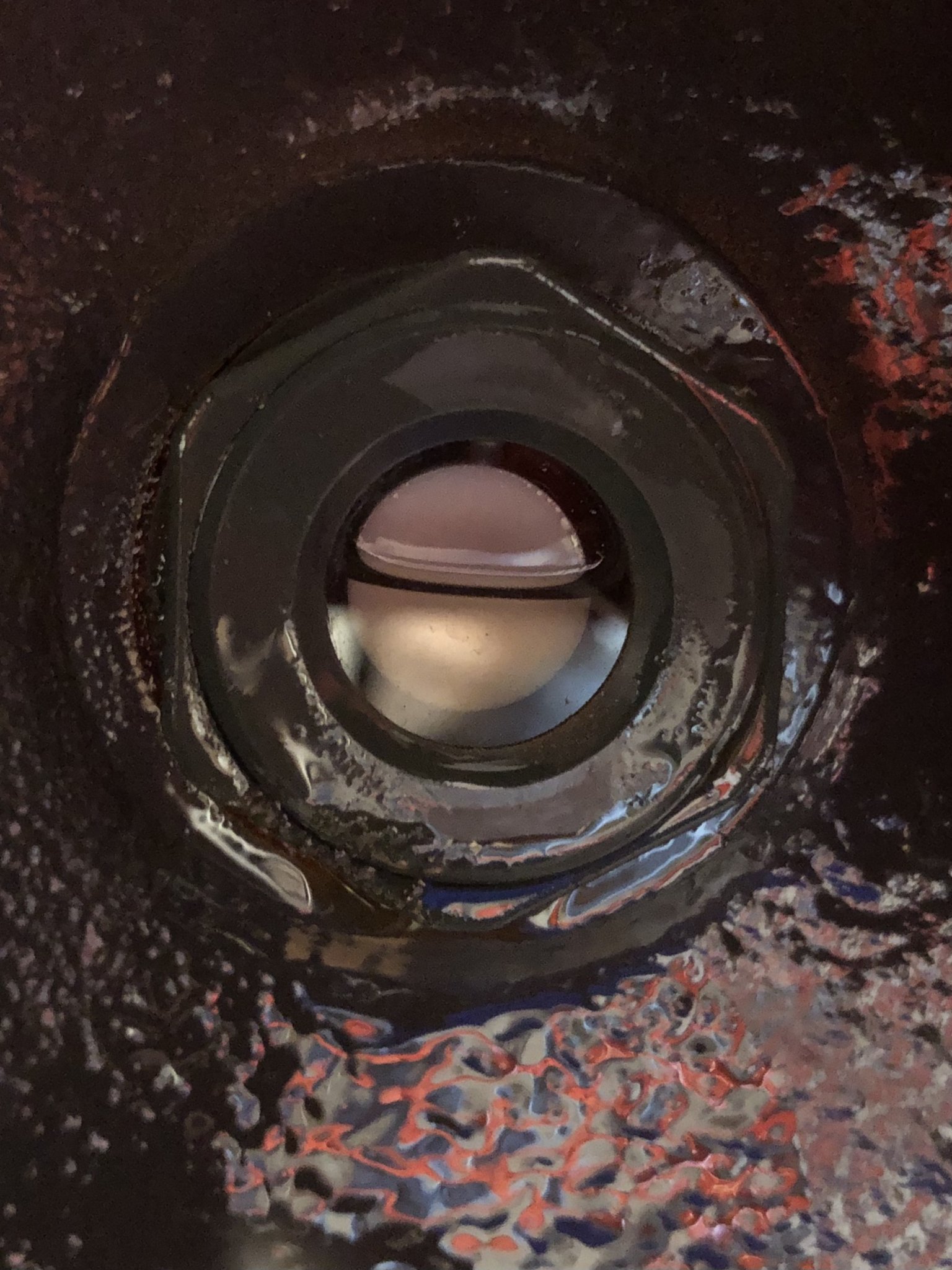

I had the same issue when I got mine. The dealer had filled it to the upper part of the sight glass but you could see the level split.
I had to stop by the dealer a couple weeks later. I walked over to the same tractors on the lot (pre-COVID) and checked several sight glass levels and even captured a photo. The fluid is a light tan. The background is almost pure white. Your photo shows the shade distinction well. If it is over full you will not see any white - only tan.

Was going to say 100% was overfilled, but it seems OP has already corrected the issue. One thing I have noticed with my L2501 is when you check the hydro oil you need to do it in the exact same place everytime, with all the hydraulics pulled in exatctly the same, 3 Pt all the way down, etc. Even though the ground may seem pretty level, ive had instances where my oil is not visible at all in the glass, only to drive onto my concrete garage floor and there it is again. It is very sensitive. You should never have to add a full gallon of oil if the oil had previously been proper level. Before adding any hydro oil take mreasures to make SURE it is actually low, and not you doing just a poor/ fast read of it. Level ground is very critical.

I agree on checking in the garage same place every time. When outside I have found it takes very little to throw it off. That is why I suggested him parking it on a slope with the left side up or jacking the left side to see if it would show the glass empty. I think after re-reading he did on a slope with the back downhill and could see a change. That with the sight glass at the front would have indicated then it was overfull but I didn't catch that then.
