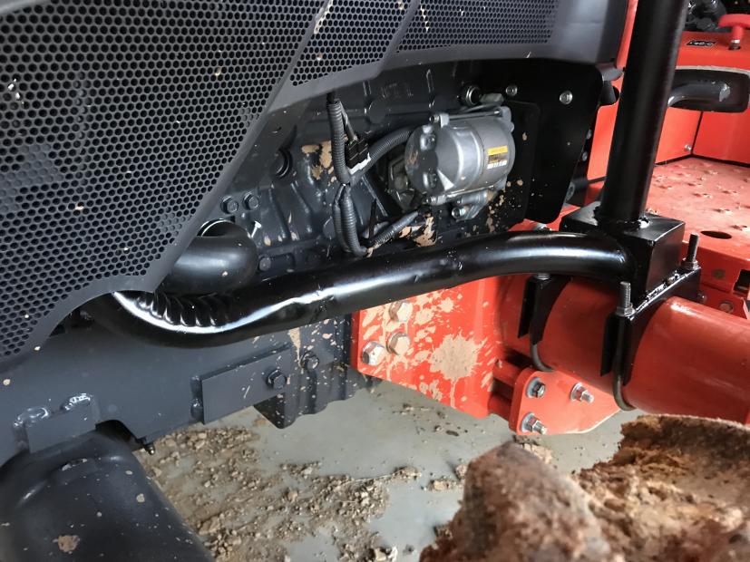

I like the idea, my old L1500 came with the upright exhaust and
I always wondered about how the bottom exhaust systems worked
out seeing the exhaust coming out of mine.
Are you concerned with engine vibration and a solid mount
to the tractor?
:confused:

dont think it will be a problem, there is a bit of flex in the elbow and horizontal part, plus motor is solid mounted, loader frame is bolted to engine block, there for they kinda all move together.

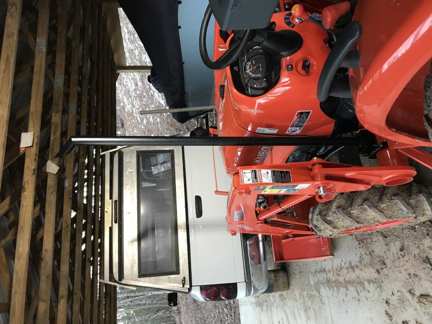

Nice bit of work. Just be sure that the stack is taller than your head when you are in the seat. You don't want to be working downwind of it on a heavy day. Ask me how I know....

its a few inches below the ROPS and well over head, went with the smaller pipe to keep velocity up and blow it away, ran it all day Sunday and never once smelled exhaust running loader and backhoe.:cool:

Funny, everyone has different views I guess. When I moved up from a B7100 to a L2501 a month or so ago, I was thrilled with the exhaust location and haven't noticed any black areas on the loader. I would be worried about tree branches hitting the vertical pipe, but nice fabrication.

for me personally its no big deal, im used to running equipment with mirrors, stacks, glass and other crap to get torn off, I am good about clearing all my trails and limbing trees up to clear with no issues.

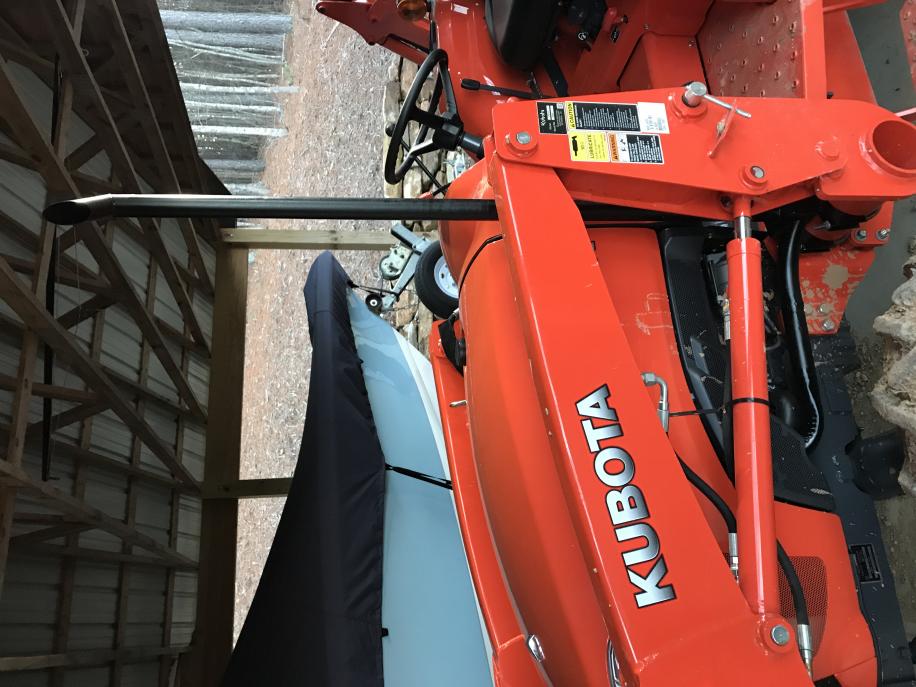

16 hours on tractor and already sick of the black stain on loader and front tie rod, a little 1 3/4" pipe and some welding and this is what i came up with.
I am planning on doing this nearly exact mod in a few weeks. Have you had any issues with the exhaust getting to hot next to that plastic near the dash. Didn’t know if I should position the vertical exhaust a few inches more foreword.
