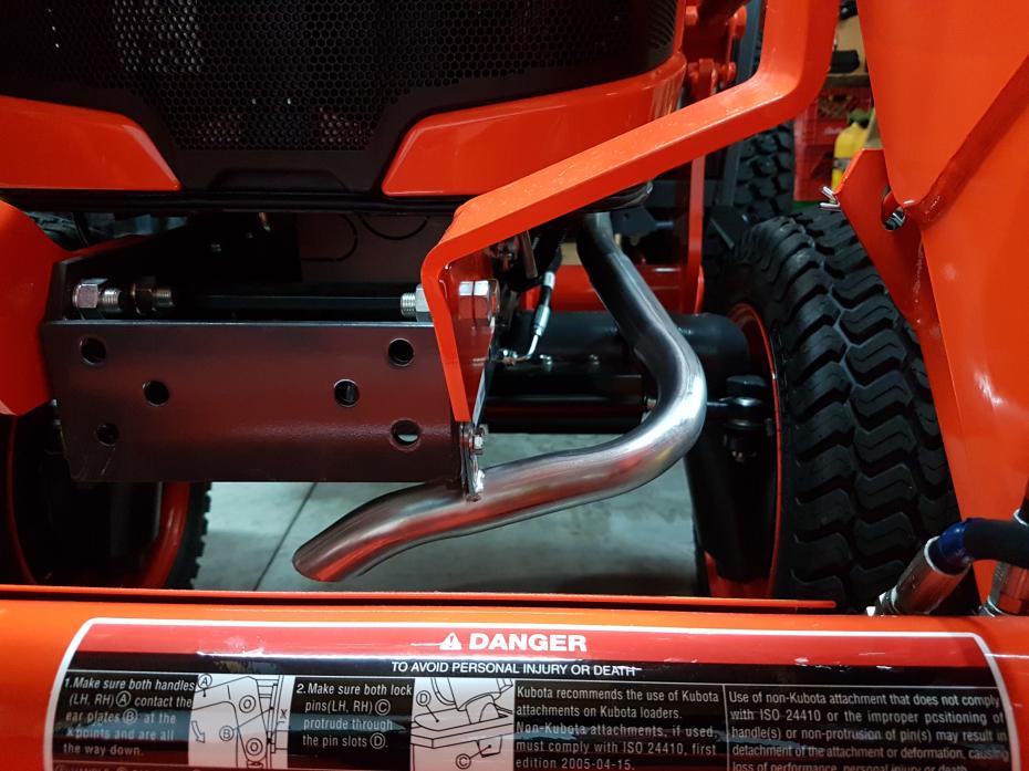

Really nice piping work you have done. I do not like verticals, however. A big selling point for me on my tractors is the low exhaust. I have a lot of woods I run thru and a vertical is a no no.
Mine make no stains, no smell and I sure like the way they are set up.:eek:

I have a b2301 that I added a 1 1/2" EMT long radius 90 that I cut with a portion of the bend used to aim exhaust at the ground behind the FEL bucket. the curve of the pipe holds it in place. Light hammering made the bend hold it in place without clamps. About 10 hrs. so far and it's stayed in place.

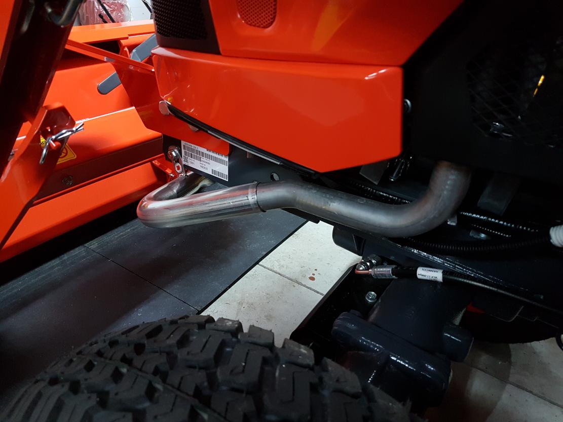

I am planning on doing this nearly exact mod in a few weeks. Have you had any issues with the exhaust getting to hot next to that plastic near the dash. Didn’t know if I should position the vertical exhaust a few inches more foreword.
no sir, i drag a trailer all around my mountain neighborhood and get things hot regularly, have seen no issues.

The original poster could easily drill a small hole in the junction box he built to allow any moisture to escape. It would take quite a bit of moisture to get high enough to reach the exhaust manifold.
