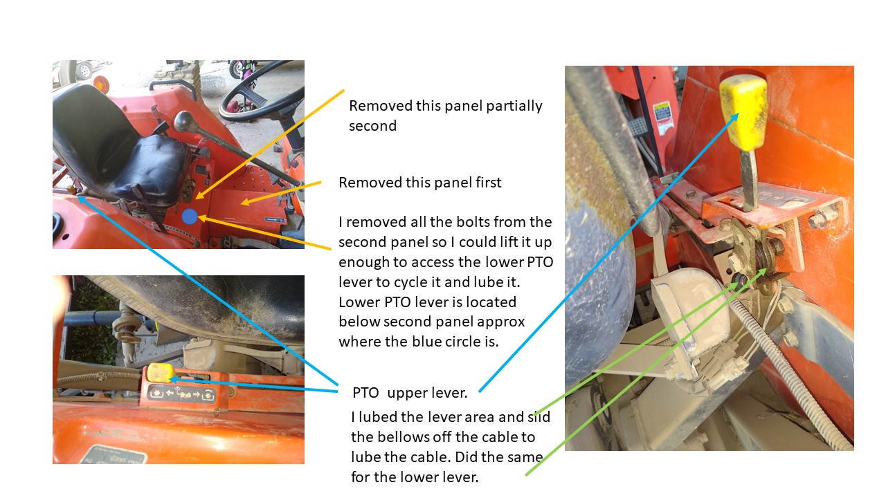

I am a newcomer as of today. I was searching for exactly the question being dealt with here. I have a L3400. I had been driving it a few days managing the brush hog by gently using the clutch to engage the PTO and disengage. This was not very safe or practical long term so I got online and searched a few sites to be sure, then went out to investigate my PTO engage/disengage levers and cables. MAKE SURE YOUR ENGINE IS OFF. After removing a cover plate partially so I could access the lower PTO lever (I coulda been a contortionist in another life!), I was able to determine that if I moved the upper lever (right side near the seat), it just slightly moved the lower lever by means of the cable. NOTE: THIS IS HOW I LEARNED WHICH DIRECTION THE LOWER LEVER SHOULD MOVE WHEN OPERATING THE UPPER LEVER. Turns out the lower lever was seized just enough to only slightly shift and not travel through its full rotation. So I took the advise given on this conversation and lubed the upper lever area, the cable, the springs, and the lower lever area. I then cycled the levers back and forth in sync with one another a few times. From there, I only moved the upper lever, watching the lower one follow the upper one. PROBLEM SOLVED. Tested it by firing up the tractor and worked like a champ. Hope this helps some of you solve your problem. My guess is if you have a cable lever system like mine, this is by far the most common problem where the lower lever gets a bit sticky due to dust build up over time. I attached an image showing what I did.

I assume it's hst. u did not specify, or I didn't see it. That is a big deal because the hst 2501 has a completely different engagement than the 2501dt
on hst models the lever is on the fender, and the lever actuates a cable that runs down to the right side of the transmission, kinda under the seat, right side, behind the tin covers. If you follow the cable you will see the lever on the side and a big torsion spring that returns the lever back to "neutral" when the fender mounted lever is released.
My gut says that the lever on the transmission is sticking.
If my gut is right, what you will do is grab your favorite can of lubricant that has a straw on it. Aim the straw in between the right fender tin and the floor hump cover, so that it points right onto the big spring. Drench it. Work the fender lever back and forth a few times and normally they free right up.

I have been dealing with a stuck PTO cable for over a year. I'd previously been able to reach under the seat and wiggle the cable within the boot and would eventually get it to disengage. Recently that trick stopped working. I've looked around for local folks to come out and help me fix it to no avail. This post was a god send. Thank you! No fancy language, simple pictures. I removed the panels as described (plus the one by the gear level so I could fully remove the panel under the seat). Then I was able to see what was actually happening and followed this advice to free up the level at the transmission (#2 in the pics). That was the trouble. The lever was fully seized up. We've lubed the snot out of it and now it will travel most of the way on its own. I can manually push it back the last 1/4-1/2". Any advice on how to get it to travel the whole way on its own?

Went to my Kubota dealer today and there is a fix for the pto problem, if you ask there is a bulletin and they have a fix. They have a new lever and spring to fix the problem. If you go to the Kubota parts online they show the new parts. Mar 13/23
