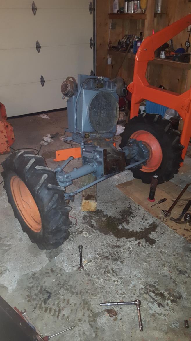

I got the front off the tractor last night. I don't have a 3/4 46mm socket to get the crank nut off. only a 1" drive socket with a breaker bar. What is the best way to keep the motor from turning over to break the nut free?
Edit- I found a 1 13/16" wrench and will try that with a pipe wrench on the splines.
I use an impact to spin the nut right off.
You can get the same effect with a wrench, position it so you can smack it with a dead blow or other hammer, one good smack should pop it loose. ;)

I never had an impact with a big enough adapter for the 1" drive socket. So I tried with a dead blow hammer on a breaker bar but the motor would just turn over. With the pipe wrench on the splines I got the nut to break loose with no damage to the splines. The wsm has fairly good instructions on getting to and removing the governor except for a couple things. Does the plate for the rpm cable need to be removed first? Also I'm quite sure the oil filter housing has to come off as well. But the manual isn't very clear on how the hydraulic pump and housing comes off the end of the fuel cam
36,700
11,421
Yes take the pate off for the RPM cable, not because it will stop you from taking it off, but it will make reassembly much easier as you will need to line up the tang to the fuel cam.
The oil filter housing is what they call the gear case, and yes taking that off will reveal all the guts, also note under the speed control plate you will see a small spring that attaches the governor to the cover, remove that spring before removing the cover.
Do not remove the hydraulic pump and housing as there is no need for that.
