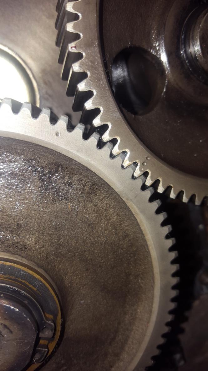

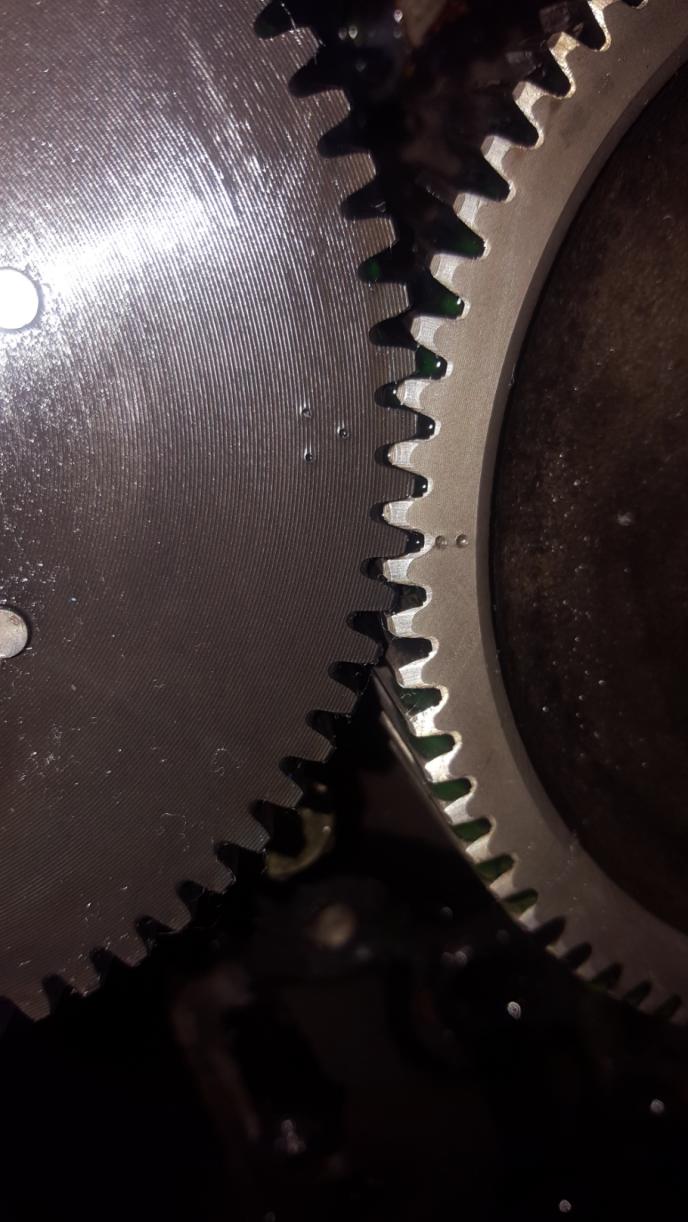

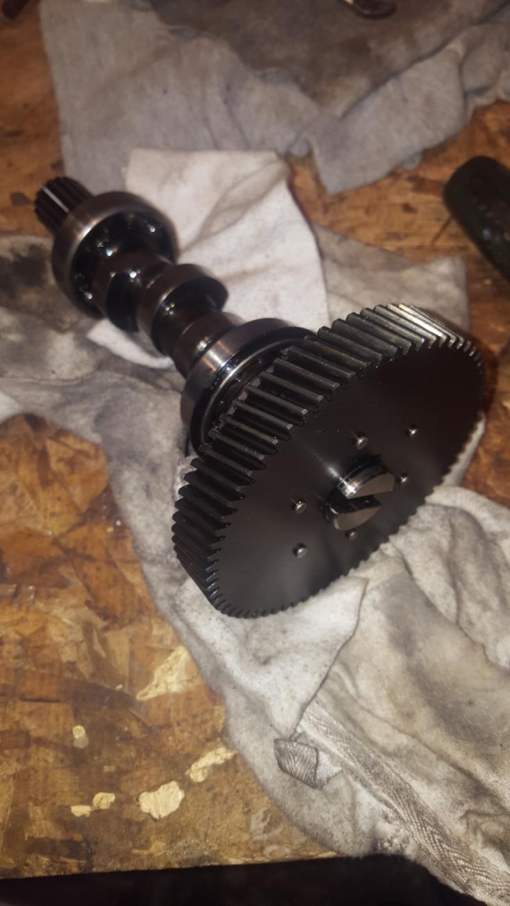

I got the timing cover off. I ended up having to take the hydraulic pump off to get the gear off the end of the fuel cam to pull it out the other side. I noticed both the fuel cam AND cam shaft were not timed properly to the large idle gear in the center. Both are off a few teeth. Looks like it was apart to fix the plug that comes out of the center of the cam shaft and wasn't timed when re assembled. Not sure this would cause the main symptoms I was having with it reving out of control at lower rpms but it's been starting hard and didn't seem to rev out smoothly. So with the fuel cam off i removed the snap ring for the injection pump gear but I cannot get it off the shaft to remove the guts to the governor. Should I use a press get it off?
36,715
11,435
It most likely was not out of time, being that far off, if it was wouldn't have ever let it start or run.
Kubota timing marks only line up every 128 revolutions of the crank, so you are just in the middle of that cycle.
When you get done working in there, then you line up all three sets of marks and you're good to go. ;)
You can use a press just be very careful with it, or you can use a gear puller remove the gear.
I would first just look it over as it's a pretty simple setup, if anything is wrong you should be able to just see it.
You want to concentrate on the governor part which is the lever section of it.
Look for worn, bent, or broken pieces on it.
Ok good to know about the timing marks and revolutions. The arms for the governor look fine and move freely. It seems the problem is in the cup part that holds the bearings just behind the cam gear that controls the arms. That's what was floating around when the tractor was idling or at low rpms.

I am fairly confident I found the problem. Everything moved freely untill I put the IP back in. The arm that controls the fuel rack would then rub against the side of the pump. So I carefully bent it away from it a bit and it now works smoothly and the cup with the ball bearings on the fuel cam is not able to float around with the small spring fitted onto the timing cover. So I probably didn't have to tear into it this far but it was hard to see that's what was going on untill I was looking down the side of the pump from the front with the fuel cam out.

Yeah exactly. when I stuck my finger in the access hole I could move the governor arm back and fourth no problem and didn't see any marks on the side of the pump where it was dragging but it was just barely on it enough that the small spring wouldn't bring it all the way back to the stop on the timing cover. I would say whoever had the pump out before I got it didn't line the IP rack pin up with the slot in the governor arm and force it down bending the arm. So I am sure that someone that was more familiar with this set up would of caught it before I tore it down but I wanted to see what kind of shape the plug in the end of the cam shaft was like as well and I would say that has been changed. You have been a lot of help as well thanks!
