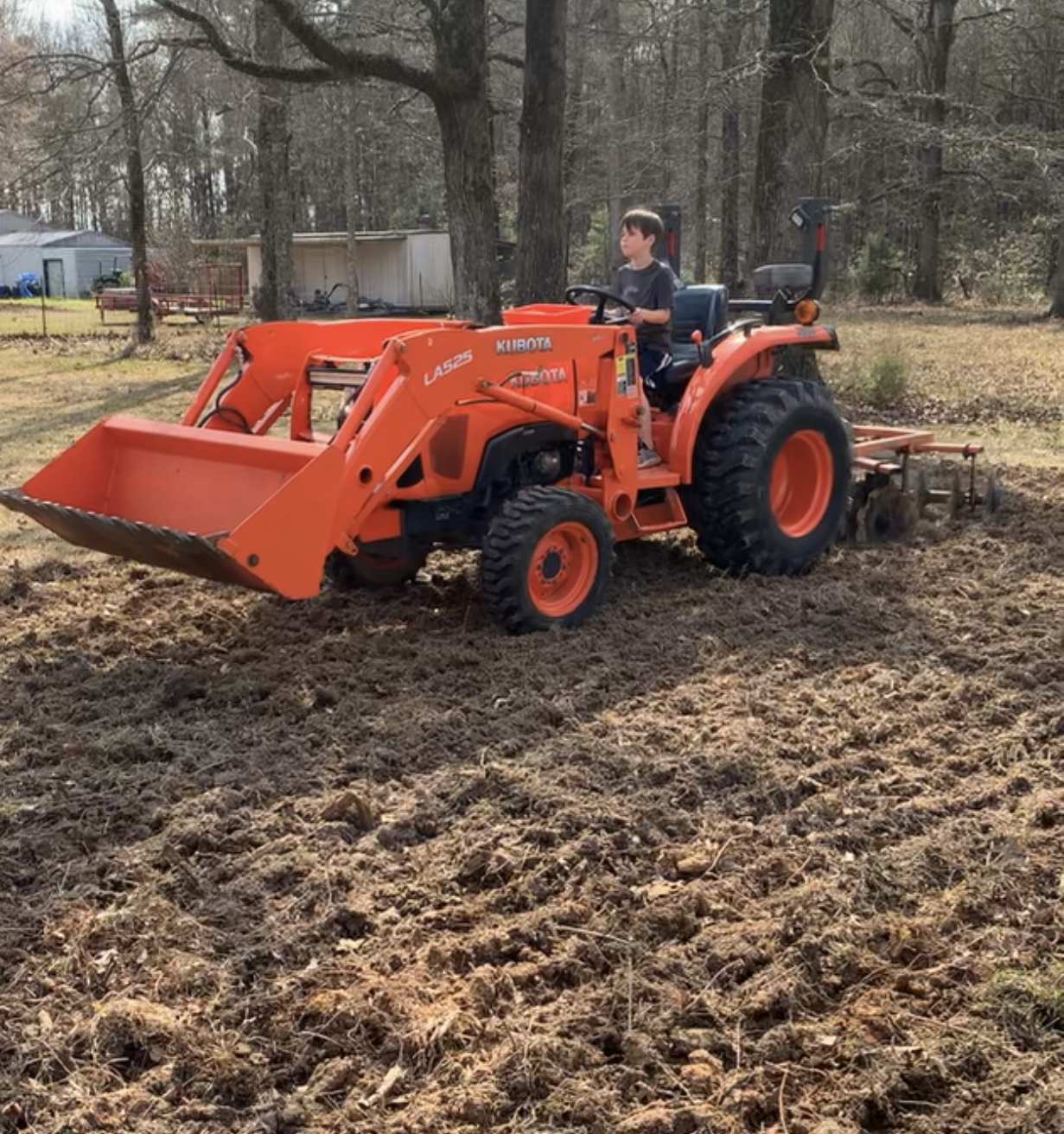

Real men shift gears 🤣
Sorry 😂
Mine came to me by chance, so I didn’t have a transmission choice. It’s gear drive.
Pros-
Wife can’t drive it (sounds like yours can tho)
It may take a couple more beers to mow with if you have many obstacles
It doesn’t whine
Cons-
you don’t know what you’re missing with a HST 😂
