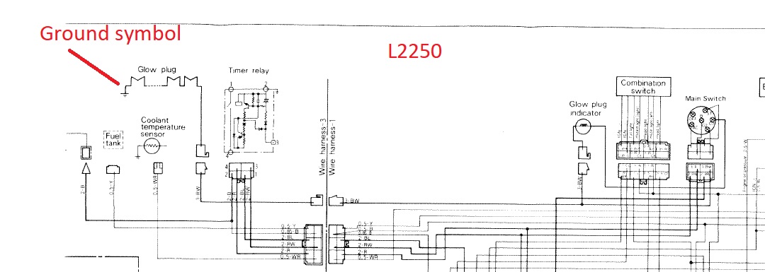

I am going to take a long shot here and suggest your glow plugs are designed to be wired in series and not parallel and this mis-wiring is why things are not working properly and you cannot measure the right resistances.
I suggest this after looking at the L2250 wiring diagram which is below.
I draw your attention to the one electrical ground symbol in the GP wiring.

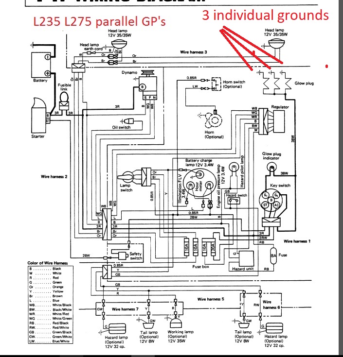

Contrast the above wiring depiction with a more common parallel wiring setup as shown below where each GP is shown with an individual ground provided by the cylinder head itself.
Series wired glow plugs are completely different than the more common parallel ones in terms of internal structure and also how they are wired.

Dave,
That wiring schematic is somewhat misleading, as All Kubota's use parallel wired glow plugs as they all have grounds on the body of the glow plus thus they share the same grounds.

Dave,

I agree that Kubota series GP's are unusual but in my experience they have existed in a few models of older Kubota's for reason's I never understood. Perhaps these are engines Kubota bought from another manufacturer. In these specific instances their wiring diagrams are different than the normal Kubota parallel wired GP's.
You are likely right that in the case of the L2250 the wiring diagram is misleading but I wanted to raise it as a possibility because of the wiring illustration.
