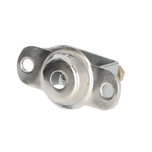

Part number is 17331-65950 confirmed with 2 different Kubota dealers. Picture of part is same as on tractor. No modifications.
What picture of the “indicator” are you referring to?
this is the glow plug indicator for a L185. Looking through the center hole you would see something like a wire that sort of glows when using the glow plugs

That's right there were 2 different options on these models, one with easy checker or non and yours is a non:
Here is one:
Here is one:
Yup, that is what I have in mine. Took too long to get to to put used part in. I'm going experiment at this point.

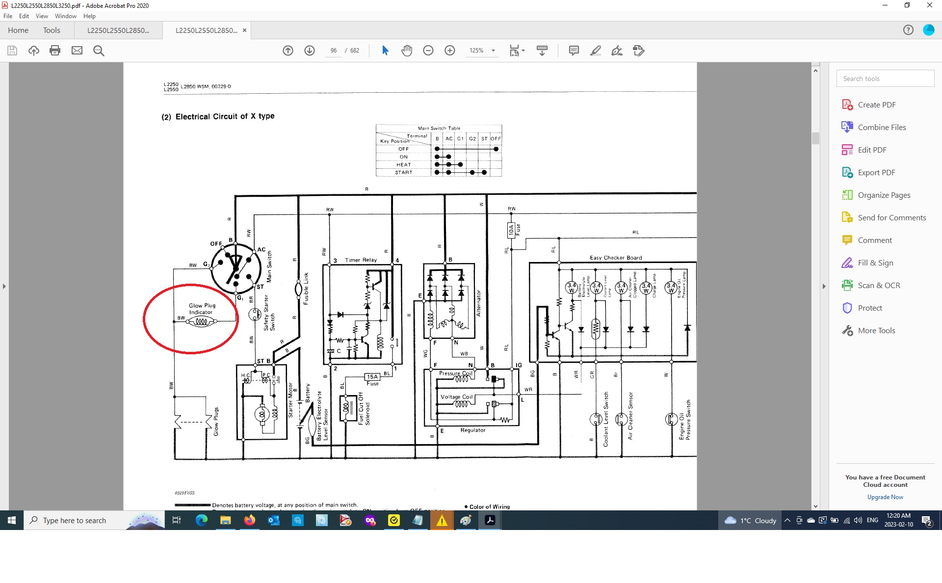

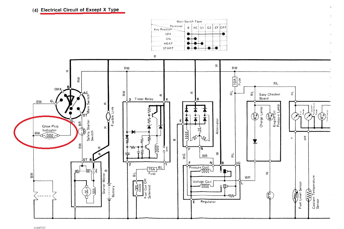

You need to be more helpful, by that I mean some pictures so as a group we can understand which model of electrical system you have on your L2250.
In my copy of the electrical wiring diagram there are two types described as Type X and the other non type X.
Wolfman feels there may be a third utilizing an Intellipanel dash.
In the type X and the Non type X the glow indicator and wiring are the same.

Both Type X and Non type X have GP's wired in parallel. To my knowledge only a few models of older L series had series GP's. An L210 being one of these.
Rewiring your tractor does not make sense to me but if you have documents with other info you need to post them.
There are manuals on line, I found one today showing series wired GP's on a L2350. This is the wiring diagram in an Operators manual. This same diagram shows a glow indicator. This diagram is clearly wrong. If you are relying on some erroneous info like this you are heading off into the dark jungle
