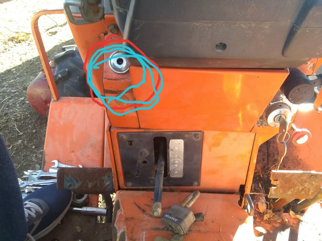

What is chrome like button on the left of the steering column? Upon looking at it closely, it looked like a possible key location? The black and white, on the back of the button wire runs to the starter?

I think the silver button is the magic for you. The black white wire on my old l185 is the starter circuit that runs through the clutch safety switch. See if you can see the same wire at the starter and clutch safety switch (which may be on the opposite side of the tractor from the clutch pedal.
I think what you are referring to is the glow plug indicator.

Per the wire diagram, thank you, it says its a safety starter switch. What the heck is a safety starter switch?
The "safety starter switch" is the push button switch on your clutch linkage, probably on the left side of the clutch housing where the control shaft goes into it.

Glo Plug indicator. Should be a coiled wire behind the hole that glows when the glo plugs are energized.

If all systems are working, when you turn the ignition key counter-clockwise and hold if for 20 seconds or so you should notice a glow coming from a wire inside the chrome cover. That is, as Flip mentioned, an indicator of Glow Plugs working.

That is not a button that moves is it? If not then you can ignore it for the “engine won’t spin problem”.

There is a coil behind the chrome button. But what was throwing me off was the metal scratches around the base of it. Thinking that a key would be inserted.
Per the wire diagram, it mentioned a saftey switch. The wire colors are correct.
