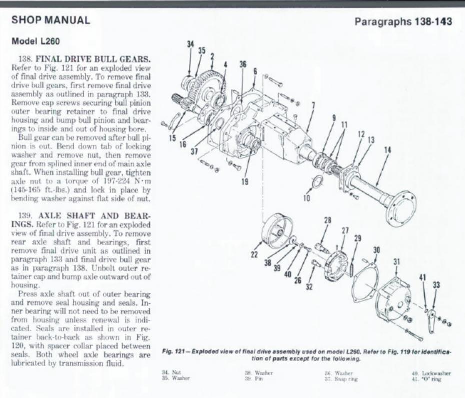

Rob - my L225 had a cracked 4-bolt flange at the wheel bearing that leaked. The axle housing came away as an assembly with the brake for that side. There's a nut on the inner end of the axle that allows removal of the flange, axle, bearing, & seal. It's some wrenching but its doable. Take care,Dick B

Hi - attached parts diagram is from Kub's website. The whole axle housing comes away in one chunk. The big nut 7 holds it together. If the brake doesn't need work it can stay assembled as I remember. The link in Post #2 above has good pictures of a similar model's internals. Dick B

Hi - attached parts diagram is from Kub's website. The whole axle housing comes away in one chunk. The big nut 7 holds it together.....
Thanks.... could not see #7 but found it after blowing it up further on Kubota's site. Makes ton more since now. Mucho Thanks.
