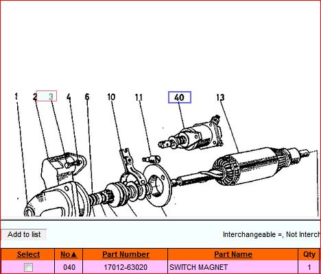

Could y'all tell me if Coleman has a starter drive for this and what part number to order? See photo. I can't figure out how to pull up a full version of that parts diagram. There's a 3digit number on mine that reads 042.
33,419
8,713
They call it an Over Running Clutch
P/N 15021-63040

Thanks, wolfman. I was able to order it. And thanks, rentthis for the solenoid PN. I ordered that too. I had seen that starter on eBay but it didn't look to be interchangeable with mine. I had found another new starter made by rareelectrical which is interchangeable, but the price hurts. Hopefully these parts do the trick. If not, I guess I'll have to deal with the starter price.
