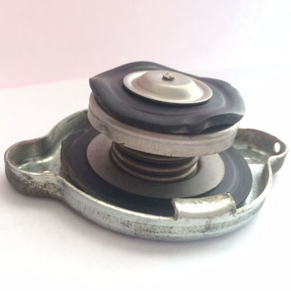

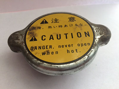

Its likely a head gasket showing its age. If whisltle is blowing, pressure in radiator is more than cap is rated for, and releasing excess pressure. In the form of steam(aka boilong over) or its pressurizing with combustion gases.
I dont recall you mentioning testing rad cap or at the very least replacing it. I have a tester so i check before replacing them. If cooling system is clean inside and out, rad cap tests good the only thing left is compression pushing its way into cooling system.

What pound cap are you using?

I'm using a genuine Kubota cap, specific to that tractor. I get all my parts from an authorized dealer. In fact, one of the first things I tried a couple of years ago was a new cap. So my current radiator cap is only a couple years old. If my memory serves me, that seemed to help, a little back then. I remember it would still overheat, it just took longer, like maybe 15-20 minutes versus the 5-6 minutes it does now.

Can you take your cap to the radiator shop and have them test it? I know, it'll take longer for you to drive there then for them to test it, but then you know facts, and not guessing.
