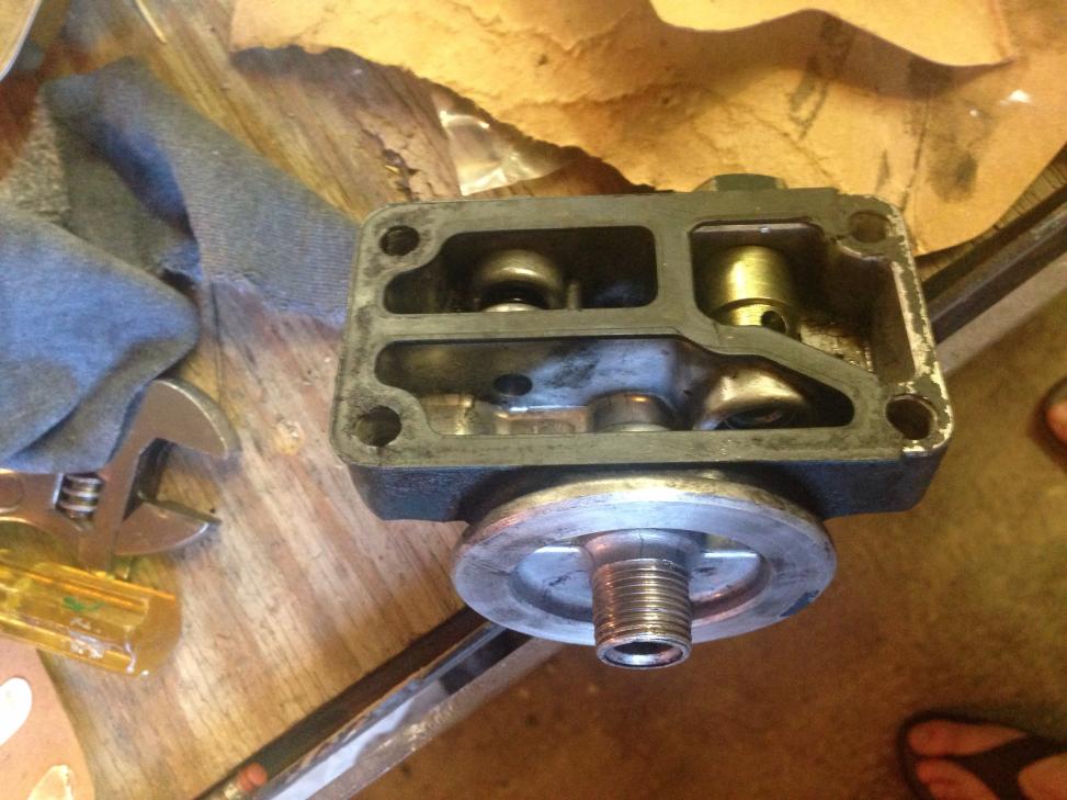

The filter assembly cover (see picture) has always required more torque than I care to admit when cranking on the oil filter. Related perhaps?
If you get it narrowed down and no blockage causing the filter to pop, but are still having trouble with the filter sealing, check the nipple on the filter base. Had a piece of equipment come through the shop recently that kept popping the filter gaskets, and you had to fight to get the filter to seal. The nipple on the filter base had gotten knocked out of square with the base causing the filter to screw on cockeyed. Apparently the mechanic servicing it at another location was using a wrench to tighten the filter, and then driving a screw driver through it to remove the filter, and ended up hitting the nipple.

It should be very hard to get that filter screw terminal to bend or get out of whack. You could test it with a small machinists square and also test the flatness of the seal seat while you are at it.
It could just be the filter seal giving way that made the 'clunk' sound or something like gunk in the pump that gave it a sudden surge of pressure, blowing the seal out. Either way, does it run right with a new filter? No leaks?

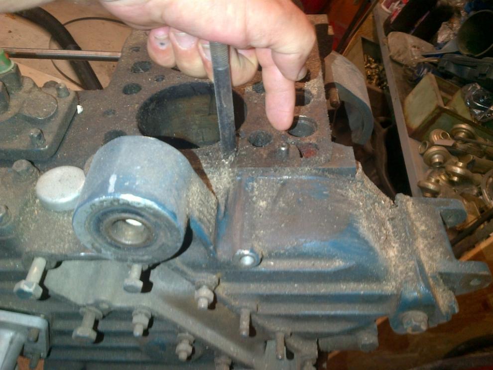

I've now replaced the head gasket roughly 6 times now.
The problem I came across was a missing o-ring on the oil gallery.

I changed the head gasket all those times because of the missing o-ring.
See the picture for the offending oil gallery.
33,375
8,694
That what I thought you meant! I almost did the same thing when I rebuilt my first D750.
Missing that little O ring would cause some serious headaches! :p

Looking at the picture of your filter base (which is not the best diagnosis tool!) the threads look fairly rough like it may have been slightly misthreaded in the past and then cleaned up.
Since you have it off, I would proceed with getting a new one (like I think you already are). If you can't get a new one, you may be able to get the threads cleaned up by a machine shop.
