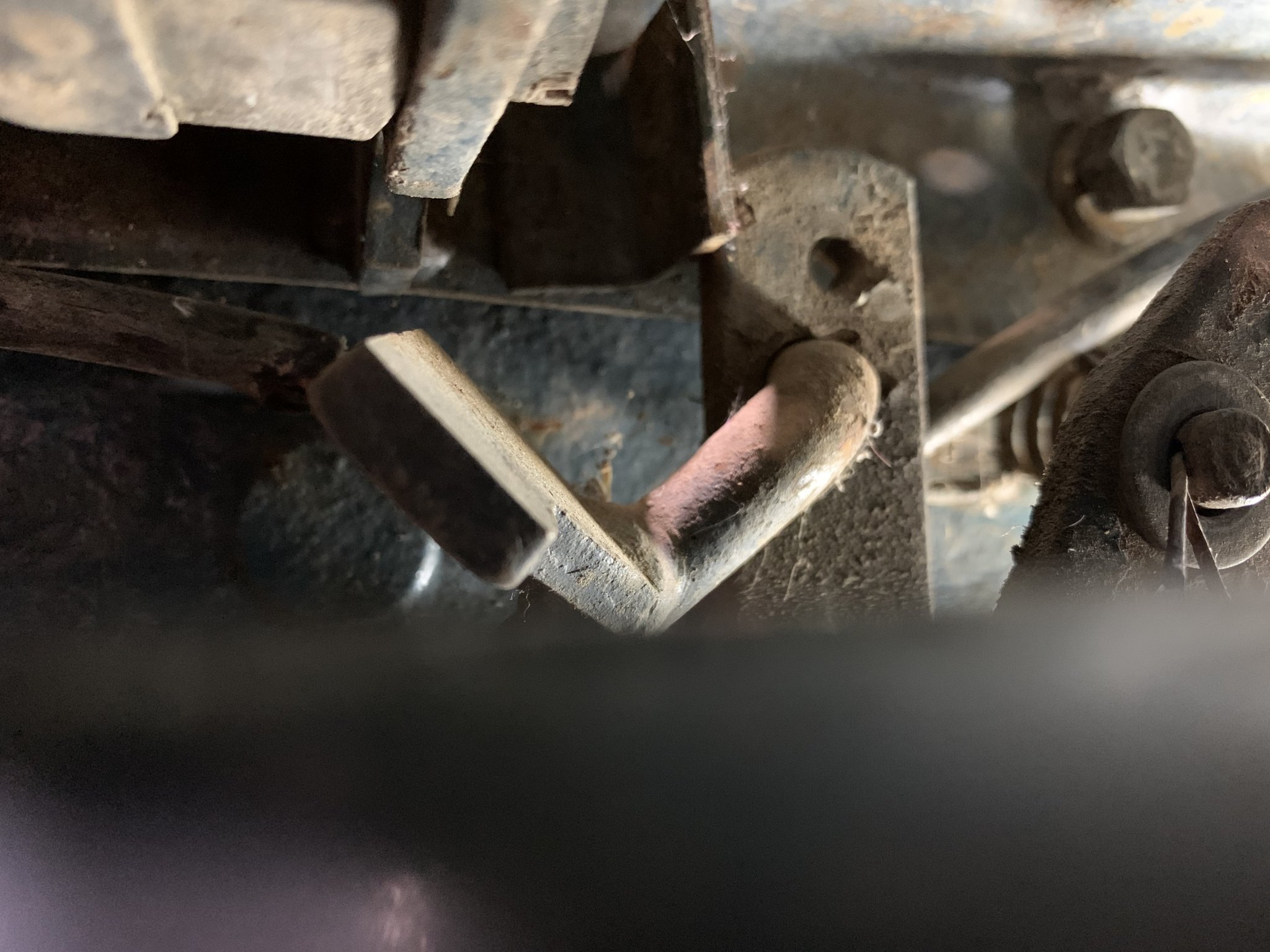

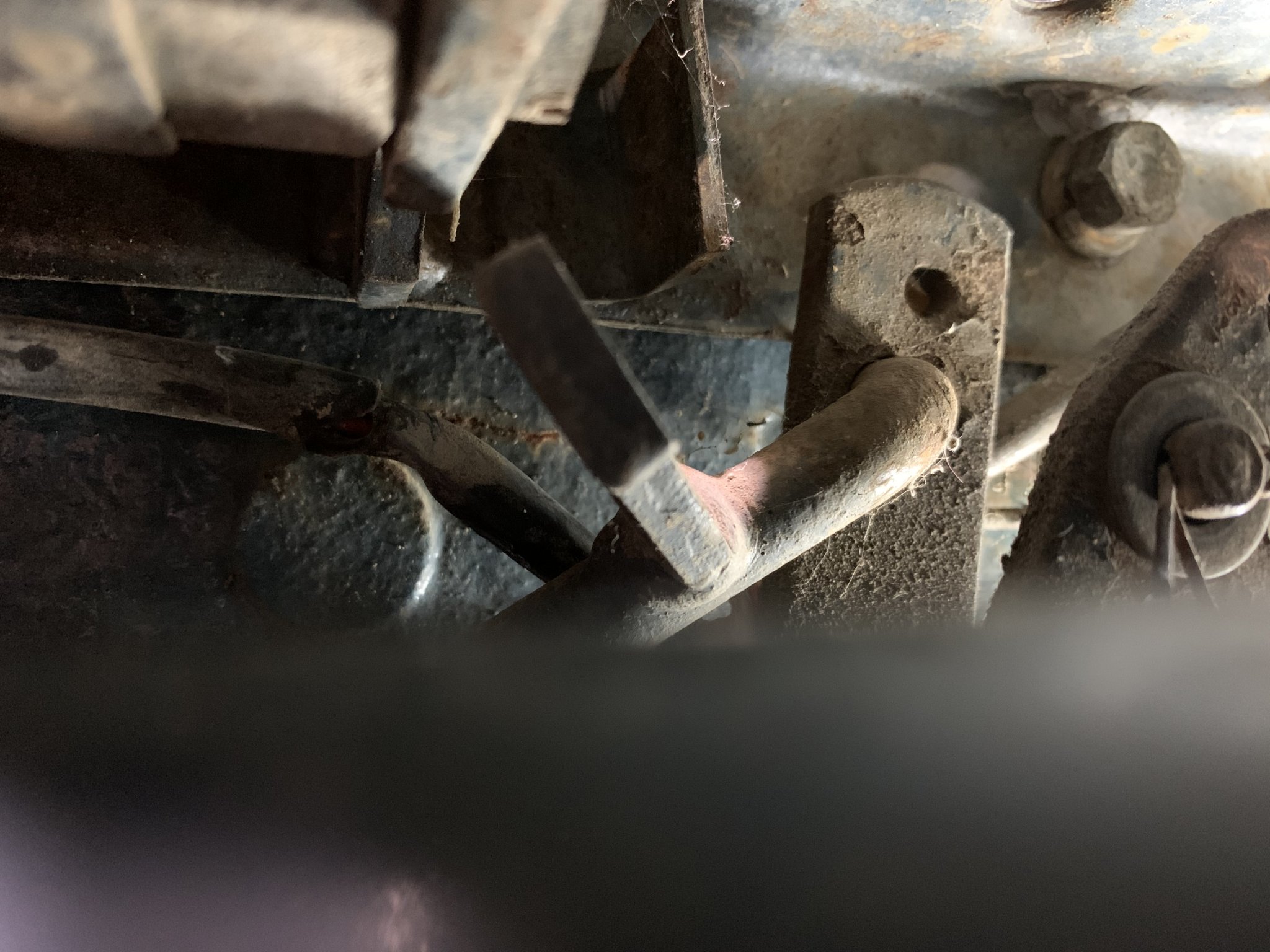

OK, It is definitely the linkage. It's not straight across and is hitting this piece of angle, first pic. The safety switch metal on the pedal comes nowhere near the switch. Whoever took it apart before me lost the cotter pin and used the spring to hold it together.

While stopped, I can press the clutch and I can feel it move, also opened inspection plate and verified contact, and it will not go into gear. I did install correctly. I think I have it figured out as the problem is the linkage at the pedal.
