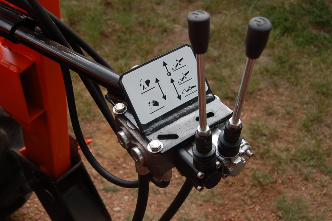

So this has got me thinking again, if it doesn't have live hydraulics then how does the bucket raise and lower, does it only have lift on the up and rely on gravity to tip the bucket? Not being near the machine makes it hard for me to work out
Cheers Norm
Not sure what you are thinking "live hydraulics" are,
however on a L1500 if the tractor is running the hydraulics are working.
That includes the 3-Point and anything else "plumbed" off the transmission / rear end.
Again I can not speak to your setup, but mine is controlled this way....
The left lever controls the up / down tilt of the bucket,
the right lever controls the up / down and float of the loader assembly.
Hope this helps.

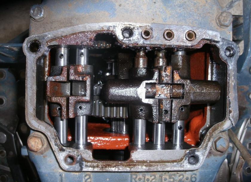

jkk04
kubota l1500, JD 410 backhoe,MF 30 tractor, IH TD14 142, BCS 715 tiller

Hello, Wolfman,
I am newbie at this site and purchased l1500 recently.
Removed the reverse gear. It was much much easier to remove it through the steering assembly box hole that need to replace anyway.
I am wondering how to rearrange the shift forks after replace reverse gear.
Anyway it can be done easily?
I don't see any interlock balls on the rails on l1500.
other question is anyhow it can be made more engage the reverse gear to the main gear like bent reverse shift fork or????
Thank you
Jkk
33,408
8,712

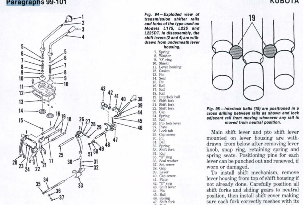

If the interlock balls are missing then that would explain why the gear is so beat up.
I don't know of any way logically to bend the forks to get more travel as bending then would also not let it travel far enough back to disengage.
Thank you for replying.
Probably they were missing long time ago.
Do you have any picture for locating the balls on the rails?(attached picture)
Also, do you have any easy way the forks back on the gears then set top plate on?
Thank you
John
