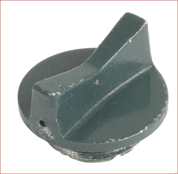

Is there supposed to be a breather on the gearbox and could this be blocked causing this leak?
Yes, it's normally under the seat and should have a ? shaped rubber hose on it.

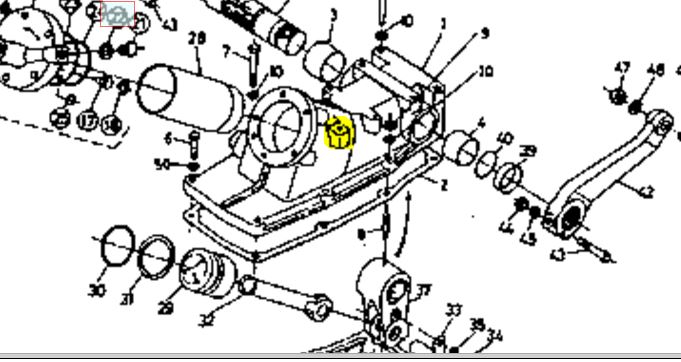

there is an oil leak on top of the gearbox, coming from the plate the gear levers are mounted to. Is there supposed to be a breather on the gearbox and could this be blocked causing this leak?
Cheers Norm
I just looked at mine and I do not have a breather,
parts list only shows a gasket (14 in the diagram)...

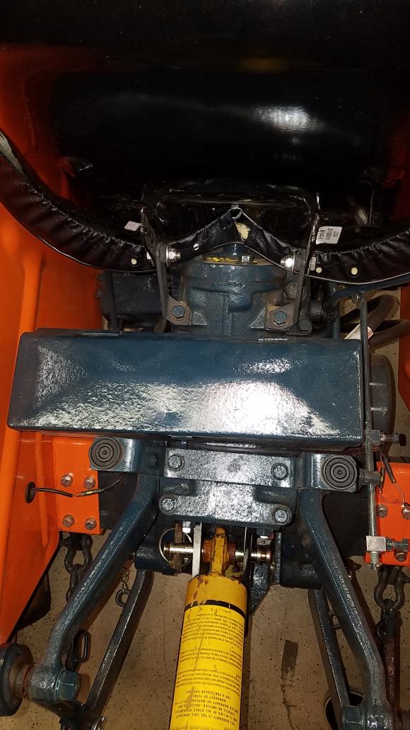

Lift the seat and take a picture and I'll point out the breather or where it should be. ;)
billrigsby
Mar 17, 2015
1,036
217
Florissant CO USA 8213'
www.facebook.com
Bill,
This is under the seat.....
And this is directly in front of it.....
I even checked the parts manual, do not see a breather ? :confused:

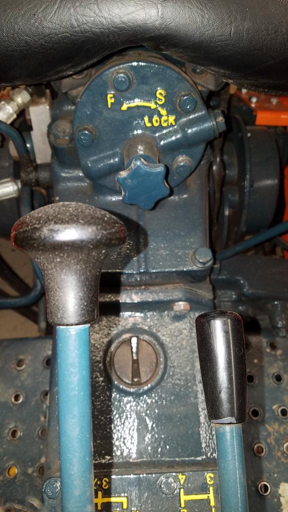

Excellent info once again, very much appreciated, obviously the vent hole is blocked. Every photo brings up another question and the one looking atr the control adjuster with F and S on it I think controls the lift/lower rate on the hydraulics, correct? The 3 point linkage is obviously not live hydraulics with just lift control, not lowering. This is all run using the gearbox/diff oil? This machine is also fitted with a Bulldog loader, any clues as to where the pump and oil tank for this is fitted. Sorry for all these questions but I have only looked over this machine briefly as it is at a mates place about 3 hours drive away and I only get up there every month or so.
Thanks again for all the help, much appreciated.
Cheers Norm
billrigsby
Mar 17, 2015
1,036
217
www.facebook.com
That is correct, controls the lowering rate. And runs off the gear oil.

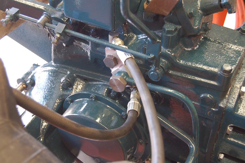

I can not speak to your setup, however my Great Bend loader is directly connected to the hydraulic lines via an adapter and uses the internal gear oil.
I think this is the standard for FELs, Backhoes may have there own tank?
Unfortunately I do not have on so I am not positive on that. :mad:
