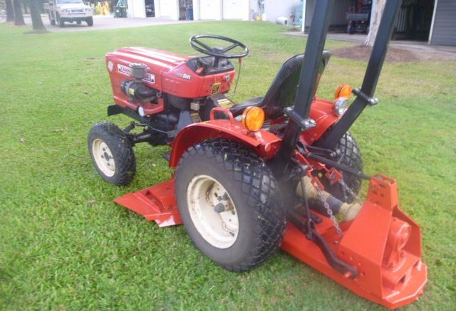

I think Karr67 is right, this type of mower deck would be too much trouble to install and remove.
Have you tried a rear finish mower? In certain situations I think they are better than a mid deck. Anyhow here is a pic of a Superior mower that was for sale on the net (Apologies to the owner). I'm not sure how you install that :D

I'm still trying to full understand why you have to have a mid mower over a rear mount mower?? I don't see any real key benefits to a mid over the rear. A rear mower you pull three pins pop the pto shaft and you're off and on your way to something else.
Plus with the added bonus of a rear discharge deck over side discharge you get better dispersal of the clippings that wont windrow like a side deck will.
You could have everything you want and a whole lot easier with a rear mount mower and a loader.
Yep another heath robinson effort :D Probably more reliable than the woods and quicker to detach...
I'll be mowing around and under trees, so there's going to be a lot of watching where the edge of the mower is. With a mid deck your not twisted right round as much.
I'm coming around to a rear deck though. How much difference in performance is there between a slasher and a finishing mower ? I believe the finishing mower is supposed to give a cleaner cut and a slasher is supposed to handle harder conditions but how much does it actually matter ?

It wont hardly take any getting used to with a rear mower. I'd jump on the 60" for that price.
And you are correct about the slasher and finish mower. A slasher is a rough cut mower that can mow down thick tall grass and sapplings usually up to an inch and a half. The finish mower is a finer cut for lawns. It'll leave the same cut quatlity on the rear mower as a mid mower would. Much like a riding lawn mower.
