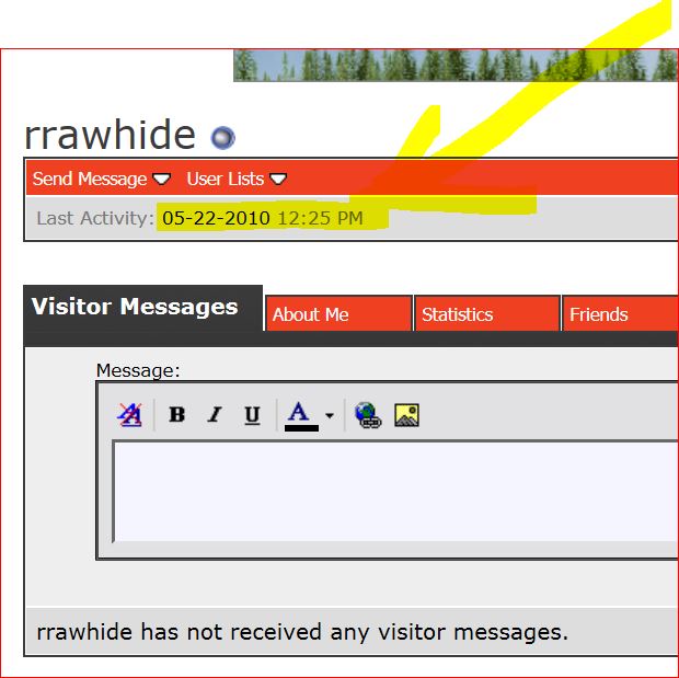

I wouldn't hold your breath on getting an answer from him.
It's been 4 years since he was last on here:

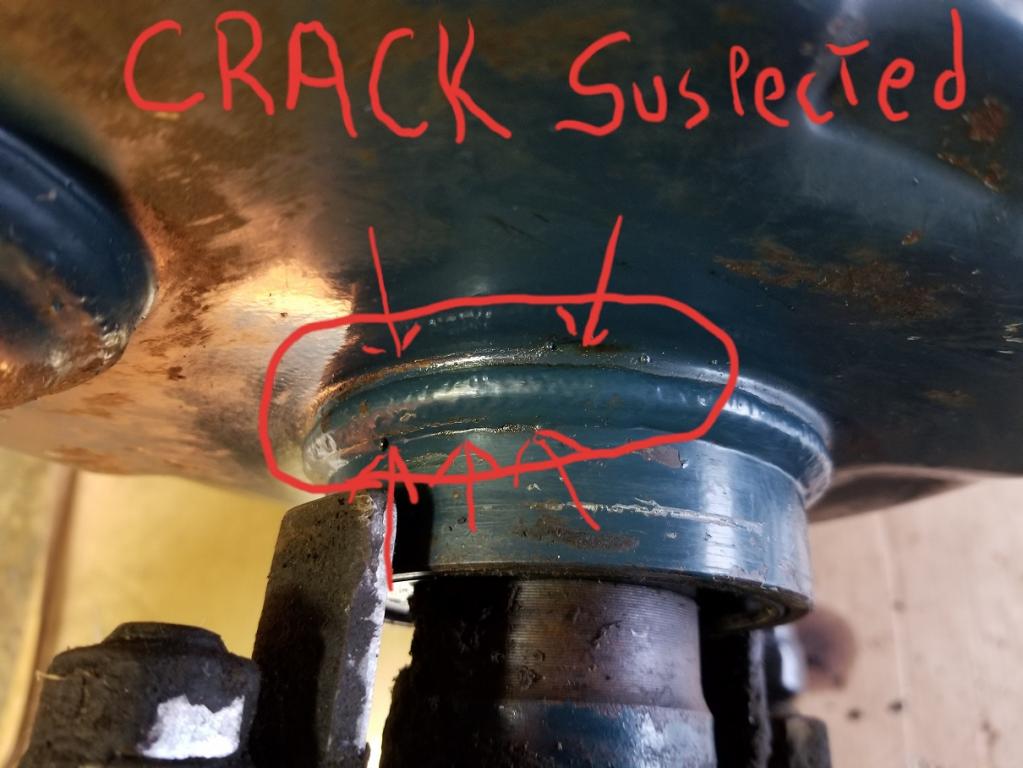

Hi North Idaho Wolfman...saw the message above and grinned.....had to post this project I'm currently working on.
So......do ya think I could just weld this up after I get it taken apart?

You can weld that one, it's not cast! :D
But yea if it's too bad Lance can hook you up! ;)

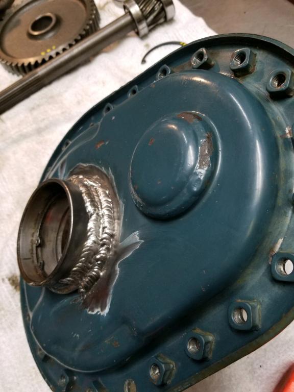

Got the cracks welded up.....waiting on the gasket and axle seal to get here to put it back together. :)
33,464
8,744
Looks like you only welded the top half, I would have recommended running a continuous bead all around, because you have now stressed the bottom half with the lack of heat and the top pulling, you could very well have made the crack travel to the other half.
But that's just surmising as you're there and you can see better in person than a picture can show. ;)

Good to know, I'm gonna go ahead and do that. Thank you sir for your insight.
