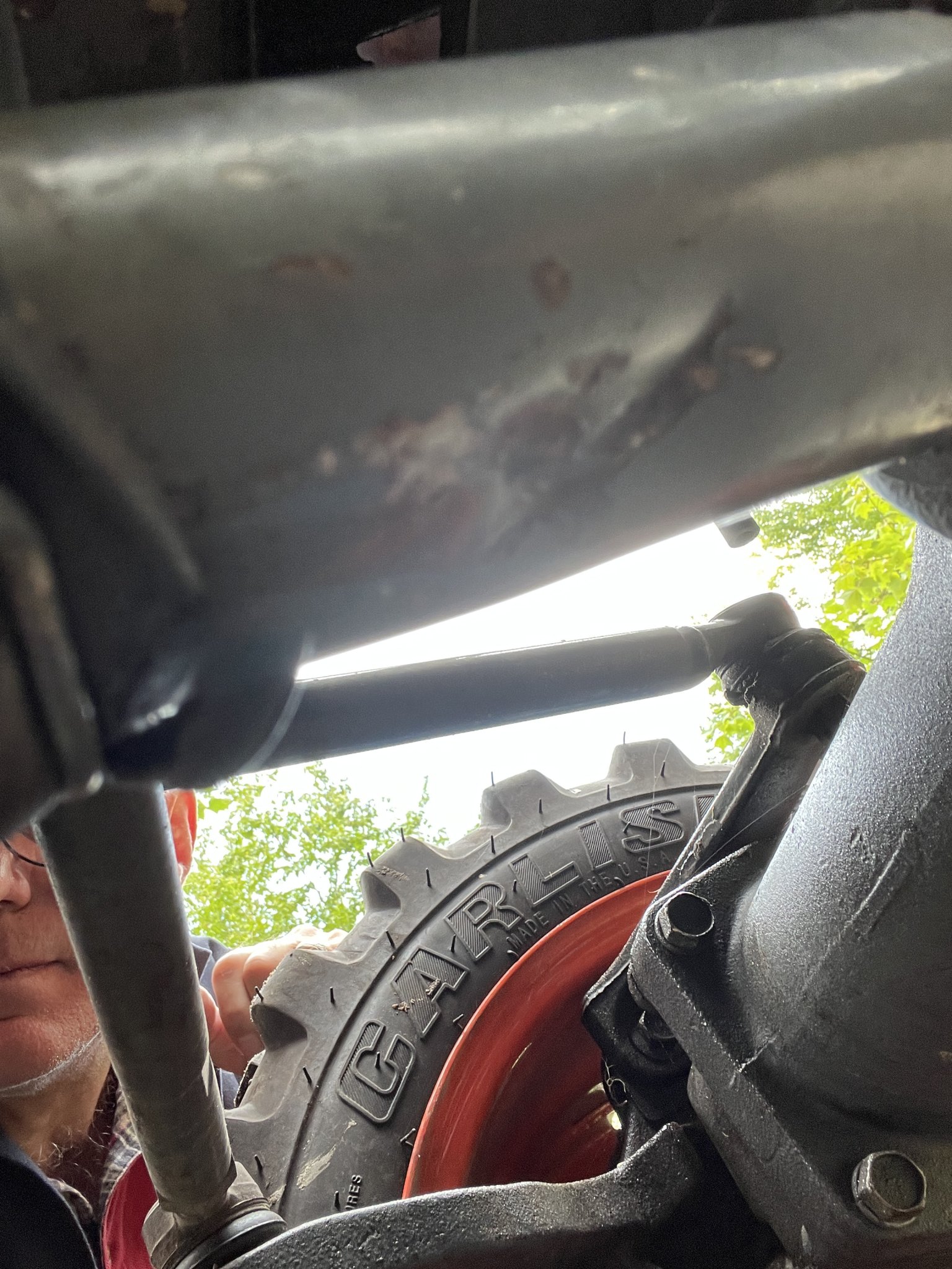

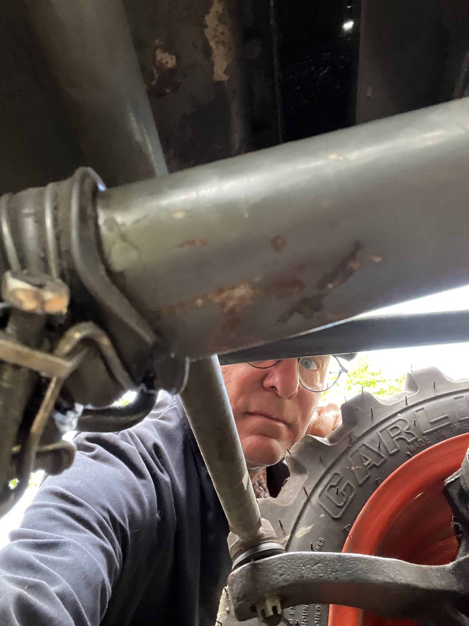

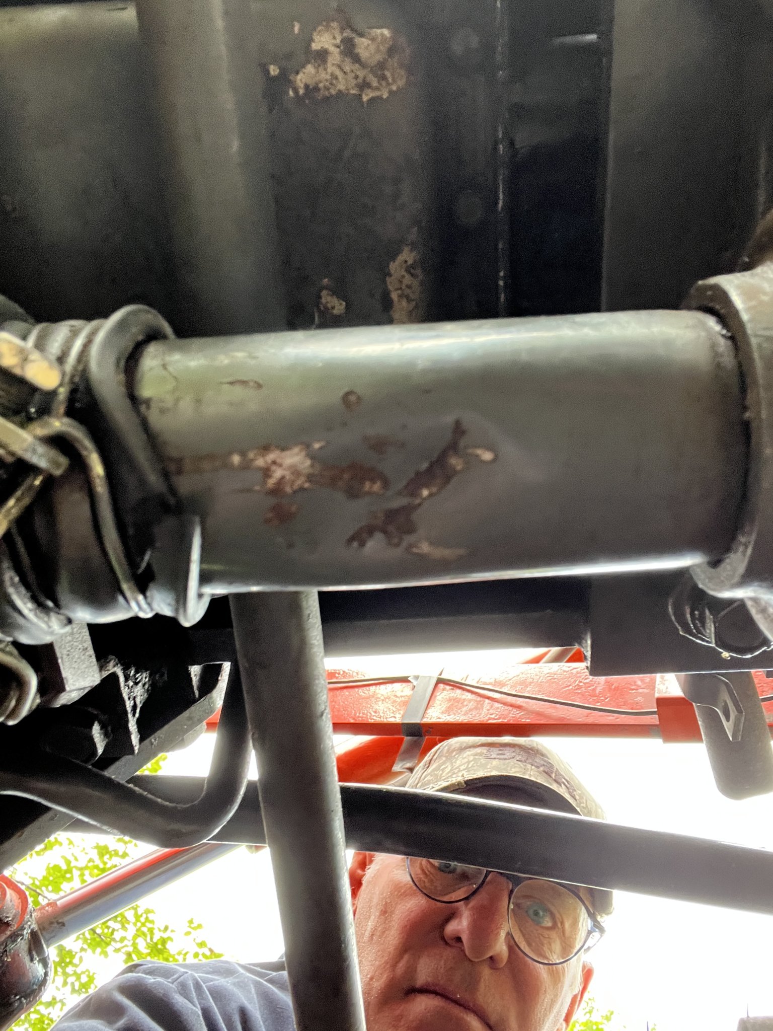

I removed alternator belt and noise still persists. Oil level ok but there is a sleeve damaged on the front axle it doesn’t look very deep. Your opinion
