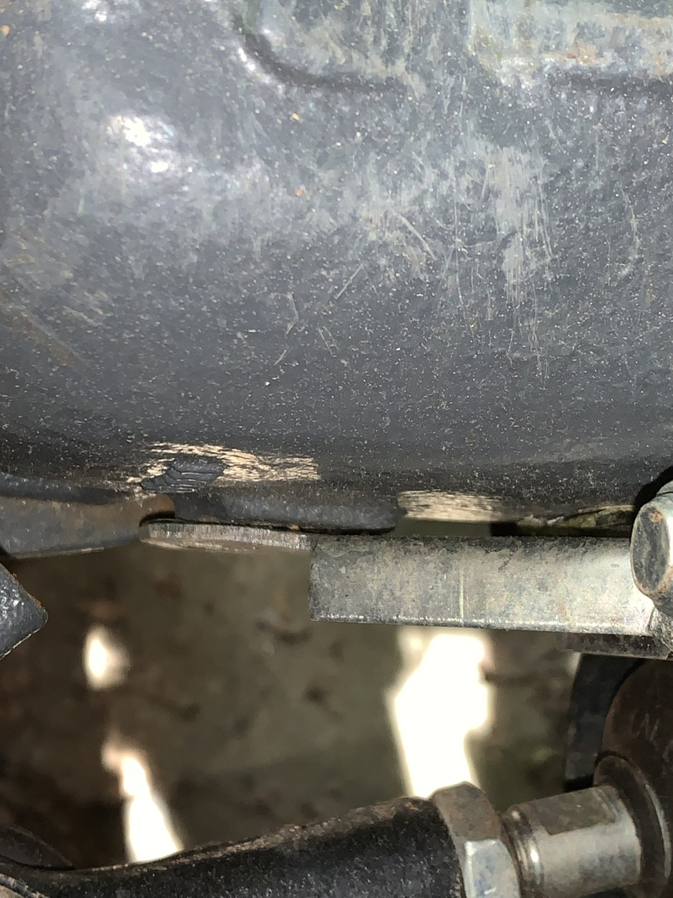

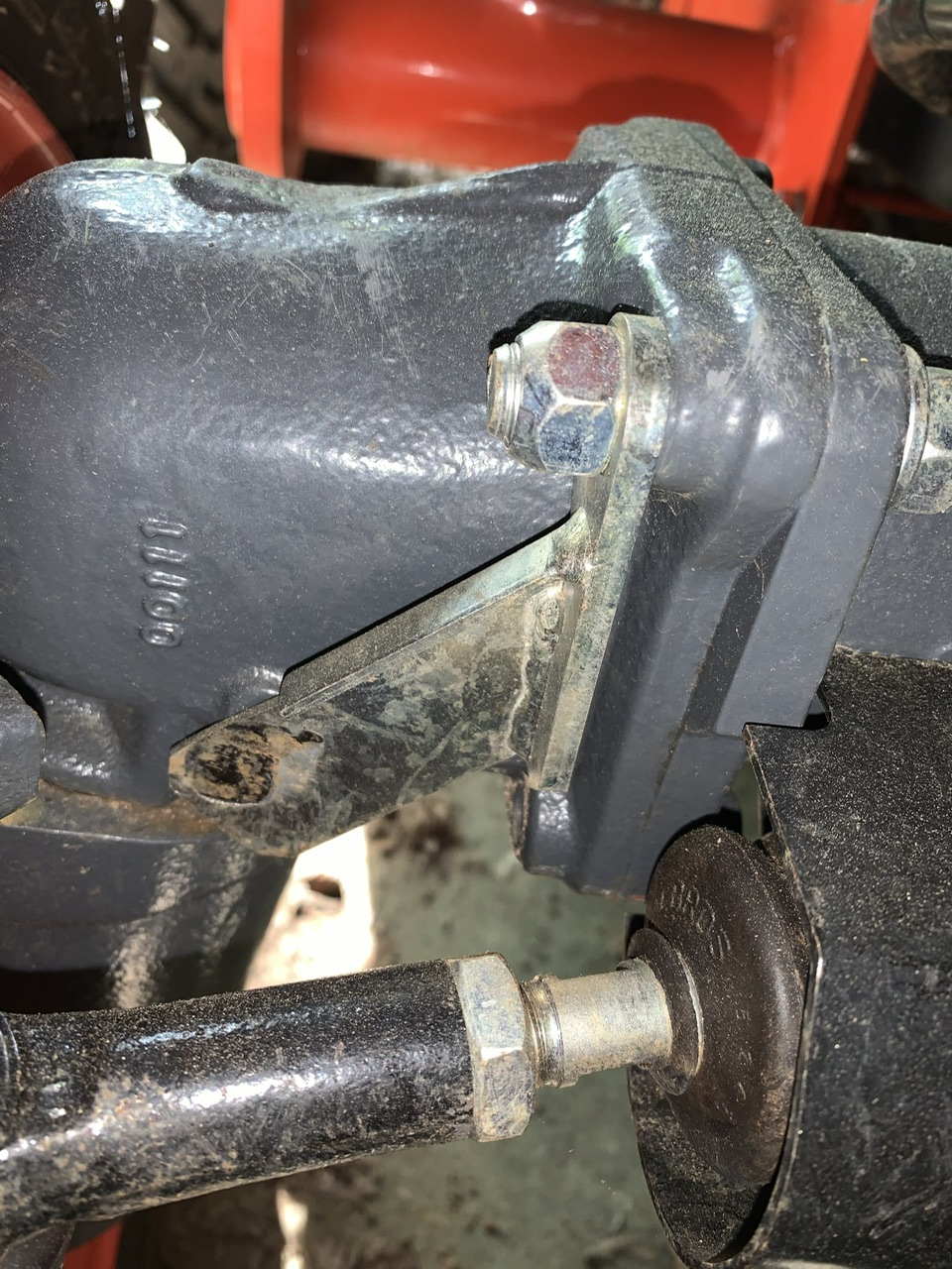

My LX2610 had them, I had the larger R14’s. There’s a picture here somewhere showing how minuscule they are.

Found the pictures. This was on my 2610, not sure if the axle is the same in the 4020.
I don't know all of the design / shape diffences, but the 3520 & 4020 model's front axle is 4" wider than the '10' series were. *the new 2620 may have the previous front axle, I'm not positive though.
I think the wider axle helps with clearance, getting the tires out little further from the tractor.
